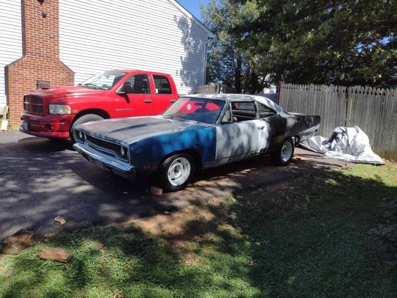

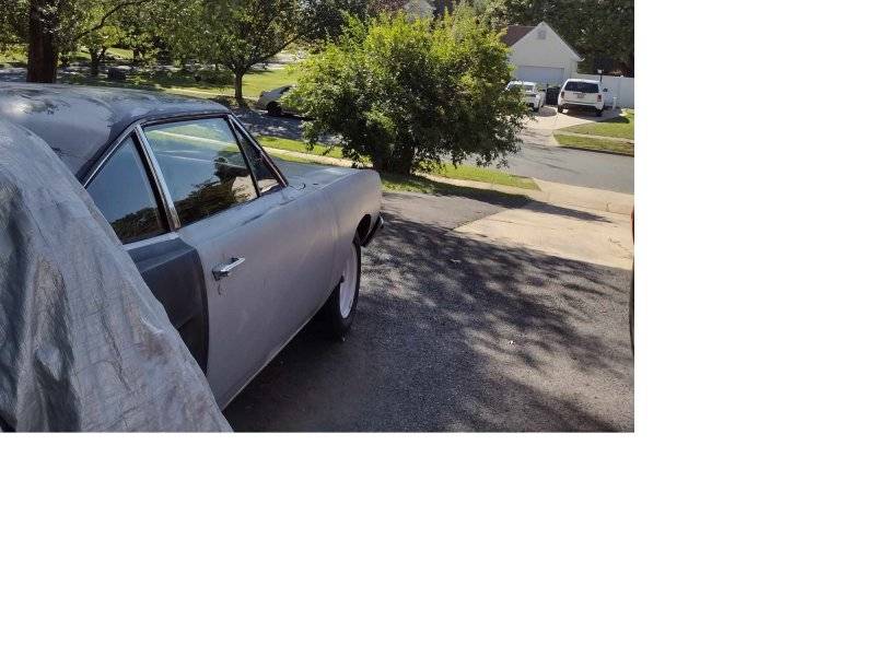

Guys
I just placed my Roadrunner door glass but it stops before it should. Ant help would be great.
Guys

Both sides have the same issue so I am researching adjustment information on this but Roadrunner is getting closer to be on the road.
