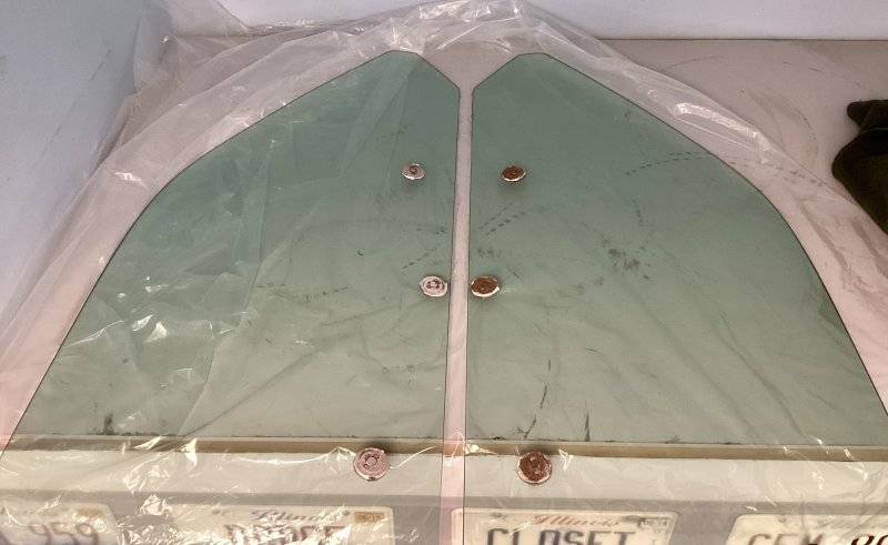

Hello all,
Have a set of door glass I picked up with some Dodge Magnum and Dodge Charger parts. Wondering if all two door 75 -79 B Bodies uses the same door glass. They are PPG tinted with a 114 date code. Or if someone can suggest where I can research my question, so far I am striking out. Thanks for any help you can provide!
I would think they are the same between 75-79 Cordobas, Chargers & Magnums, but not positive. I'm sure someone here knows for sure. Pretty awesome cars by the way too.
The hard tops have a slightly different upper corner, more square. (Fury, Monaco, Coronet, Road Runner where the quarter window touched the door glass)
All Cordobas, Magnums, Charger SE and Charger Daytonas plus Fury, Monaco, Coronet with the fancier vinyl roof are the same.
The overall difference is very minor, but it's enough.
