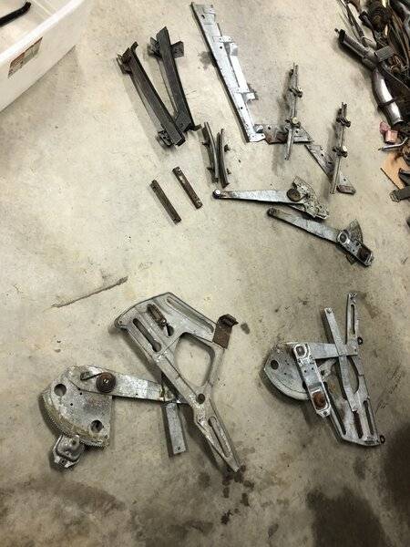

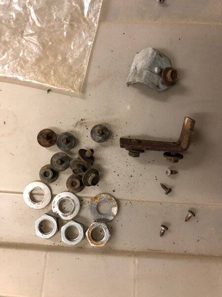

I have the regulators bolts, screws and washers for 1- quarter window.
Here are pictures:
I have all this plus the glass and vent windows.

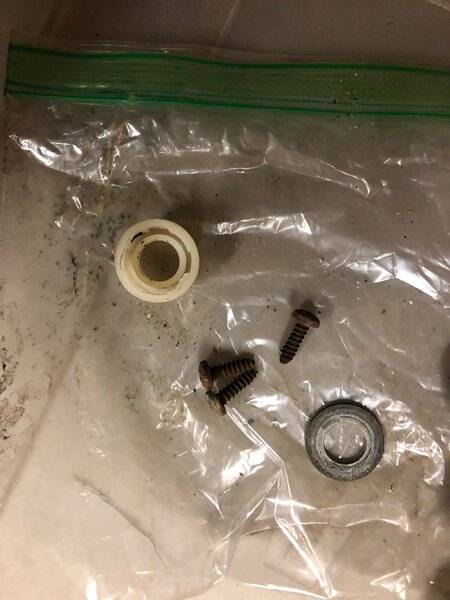

This was labeled LR quarter

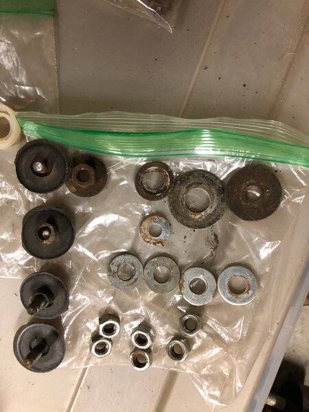

Another unlabeled bag
These were in an unlabeled bag.

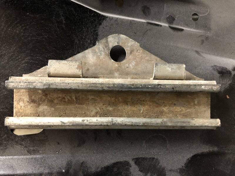

I am not sure what this is but I only have one.

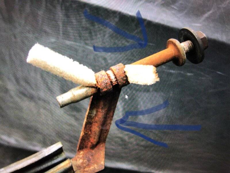

I am missing this pin and hook that goes on the bottom of the vent windows

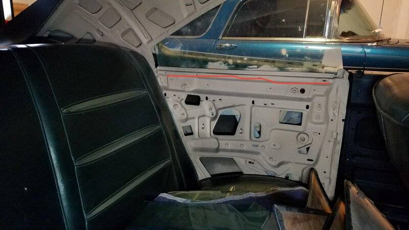

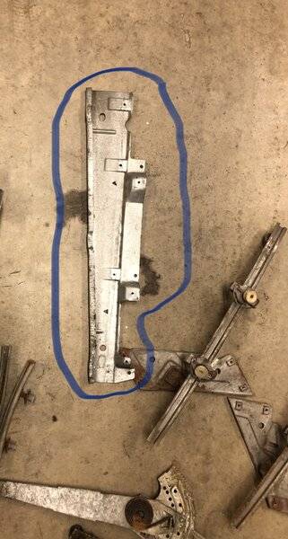

You will need a right and left of the part you have circled in the picture. They go where the red line is in my picture.
