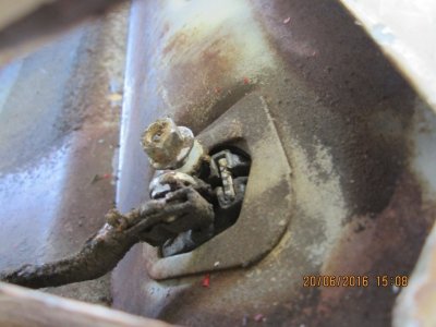

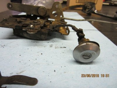

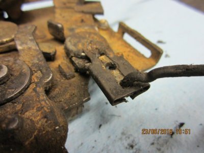

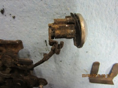

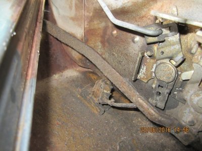

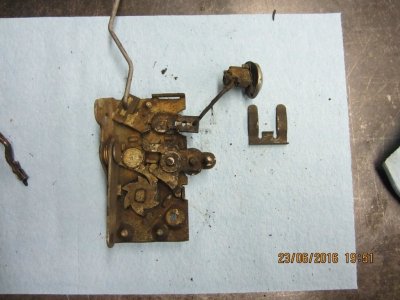

Anybody have some pics of the door locks inside the door. Im havin a heck of a time tryin to figure it out. The shop manual drawings a vague at best...
I just took my 65 Coronet doors apart. Here is photos from inside of the lock. I have more with the parts laid out on the bench if you need.
that's awesome if you have pics of the lock cyl and rod configuration where the clips go etc that would be great thanks for the help.. Pat
This is why the "Bodies" web sites are so great.Where else will you find such info,,,and with pictures !! THANKS !
Thanks exactly what I needed been apart for 10 years configure out how to get them back together. Pat
