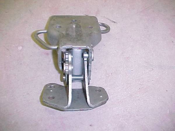

I rebuilt the door hinges by blasting them clean, grinding off hinge pin rivet head then removing it, line boring bracket and hinge holes to .4375 dia and making a new pin out hardened steel (Rc 28) with only .001 clearance, coated pin shaft with moly-disulfide dry film lubricant, welding and regrinding worn area on spring, and assembling by peening over the new pin. The rebuilt hinges work like new.
....now that is what I call a tight hinge sir.
