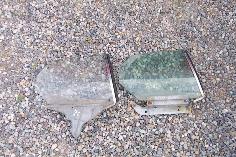

Here is a pic of the fix glass mount on the right. This one is a 71-2 Satellite. 73-4 is similar.
Thanks. Especially the pic. That’s what I was looking for.
