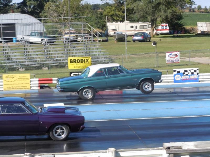

Racers,
I'm looking for opinions on double adjustable front shocks and how they can effectively be used to control wheel stands when using a trans-brake. Currently I am using Calvert 90/10 front shocks with /6 torsion bars. Rear suspension is a Calvert mono-leave / traction bar setup with single adjustable QA1 shocks.
When I foot brake it pulls the wheels up 2' for about 40-50' -- which is perfect with 1.37 - 1.39 60' times.
When using the trans-brake the front will come up 3'-4' and carry 60'+ with 1.33 - 1.35 60' times.
My goal is to dampen the front lift when using the trans-brake and retain the 60' times. I have noticed scraps / rubber on the bottom of my oil pan and I want quit beating the crap out of car pulling big wheel stands.
thanks in advance

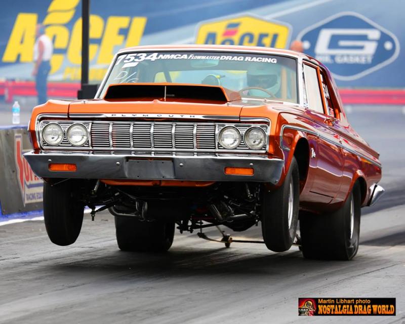

Tighten it up. I ran QA-1 street single adjustable for a year and a half. Set 2 clicks from full tight. 60 ft in the mid to low 1.30. Now it has Afco doubles. Compression full stiff, rebound -15. Carries the wheels about 6", 1.29 on the foot brake. What is your weight distribution? Once it starts going quicker it may need more weight on the nose. My 64 weighs 3340 with 1830/1510 f/r.
Doug

Though Santuff may be considered the 'creme of the crop" They may not be necessary in all applications, I certainly don't feel that I need them. For sure they're out of my budget. My car runs 9.20's easy. Pretty consistent as well. To be honest the Afco's weren't a huge improvement over the street QA-1's. I expect in the future they will help but the car set-up is pretty good. I'd try shifting weight, costs nothing. With the front end stiff it comes down soft. I run a diaper on the pan, 3" off the ground. It never comes down on it.
Doug
