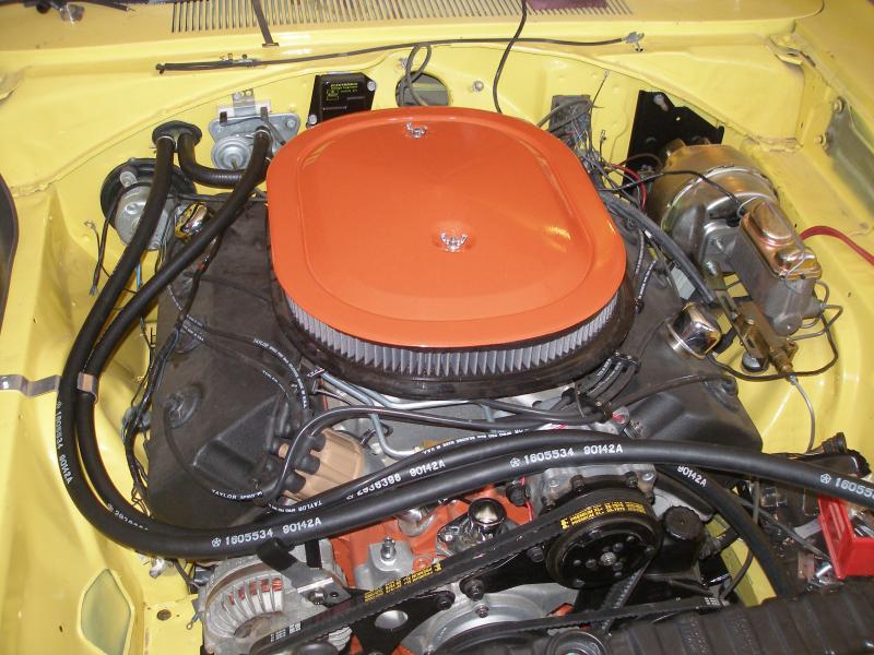

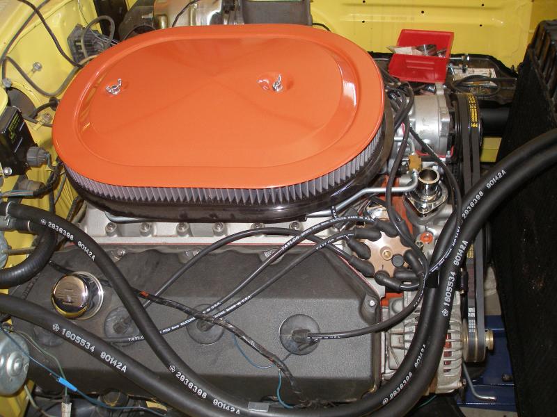

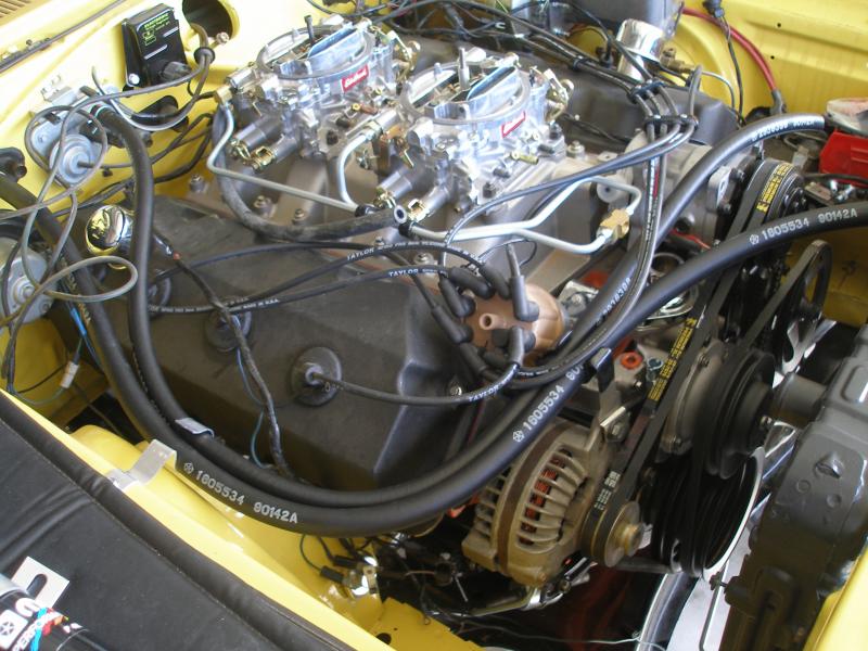

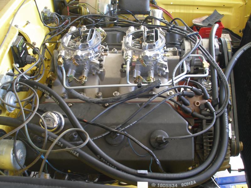

Fender well tight fit on my 70 Hemi Superbee

My TTIs are close on the Superbee pictured above.
