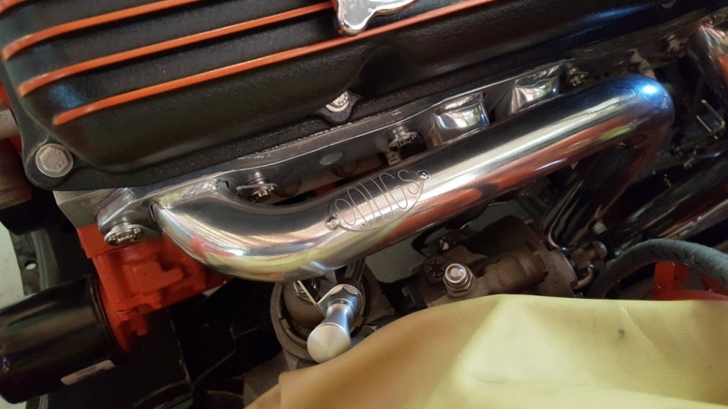

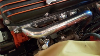

I just installed Doug's Headers on my B-body big block with P/S, larger torsion bars and very pleased with the fit and everything. I realize not the same as your A-body but I don't dsee the real difference. Used Remflex gaskets instead what came with them and used Stage 8 locking fasteners

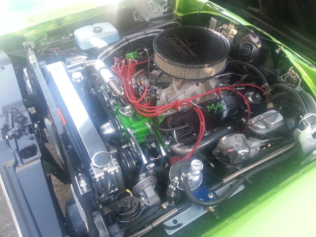

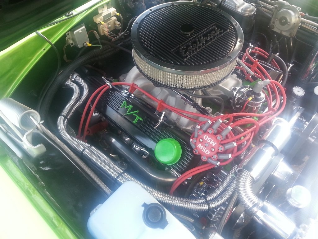

Installed Doug's 2-1/2" ceramic coated headers on 1968 Plymouth GTX 440. As you might expect, there is not a lot of wiggle room when all said and done. A mini starter c/w heat protection, is a must, within the confines of these massive headers. Should you require access to your starter later on, lets just say, it will be interesting. The only other issue, that I have noticed so far, is the PS tube, when installed without modification, is extremely close to our b-body's stock, shock mount & PS inner fender. FYI :)

Excuse the lousy photo. I have others, but can't find them at the moment.

Wow, another lousy picture, but you get the general idea, of how close a fit, these are on a 440.

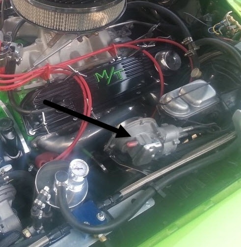

Beautiful engine compartment Oldtimer. Quick question. What is this? See Arrow...

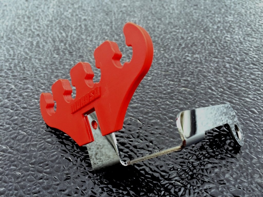

Oldtimer-I put 1 7/8" on mine. needless to say, I'm interested in knowing where you got your spark plug wire separators mounted on top of the valve covers from. I need something like that for mine

Anyways.., the wire looms that you are asking about, are actually from Moroso's #72172 Wire Loom Kit.
