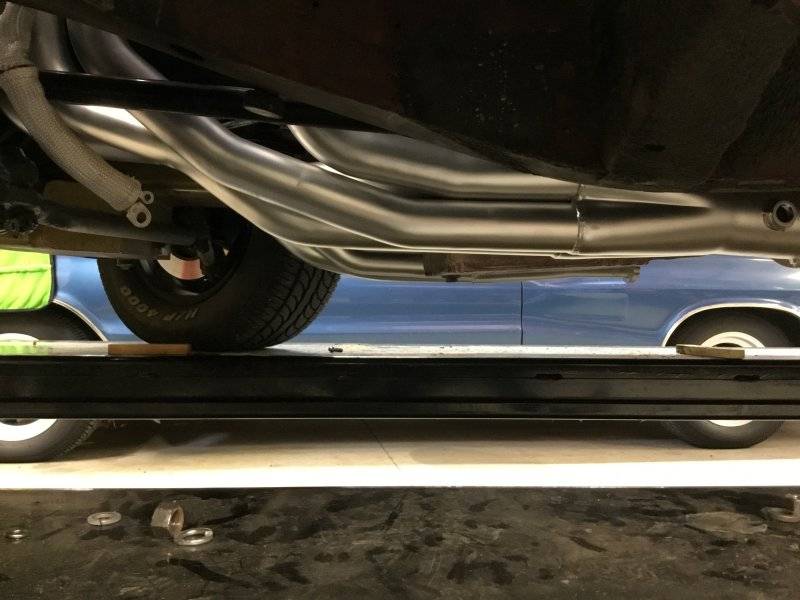

I recently replaced my old Hookers with Dougs on my 73 and it was a huge improvement in fit. They weren’t much cheaper than TTI, but I have a Lakewood bellhousing and didn’t seem like TTIs would fit.
I like mine in the '62. No hammer needed and they are tucked up, not low. They have a set for the B block 451 and another set 452 for the RB.

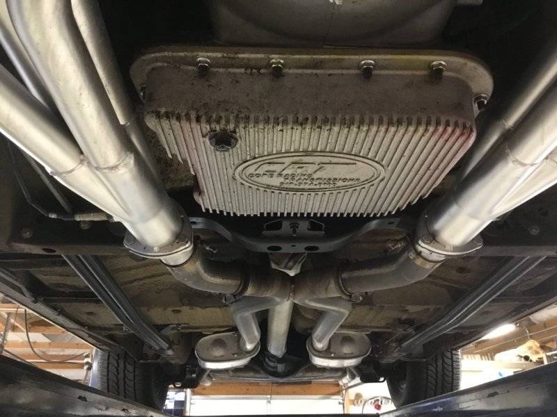

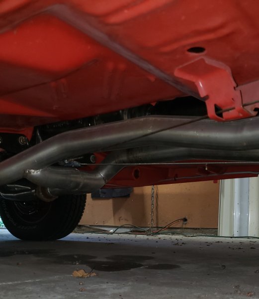

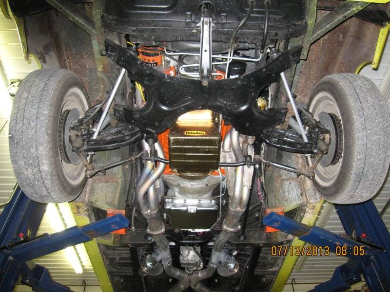

The Dougs do not align with the crossmember humps. I have never seen a set that does. One reason I imagine is that they'd be impossible to install without dropping the motor. Otherwise, fit is perfect and starter access is very good. They have to clear the floor so that and the collector size dictates how low they hang. I don't think they could do any better in that area.

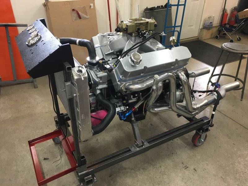

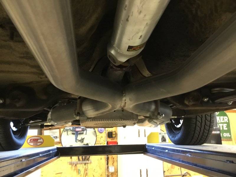

I'm building my own exhaust with 3" tubes and when I made the pieces through the crossmember from the collector I did it while the engine was out and I built in a 1/2" clearance. So they'll hang low because they're 3" pipes - but for no other reason.
You can see the extensions off the collectors here. When I made them I installed the trans and crossmember.

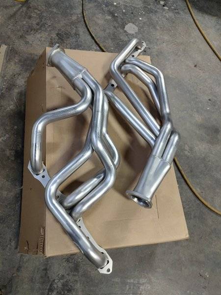

I'll post the install so you can see once I get all of my parts
Thanks
Pretty! Another part acquired from the laundry list of upgrades to be installed on the Charger.

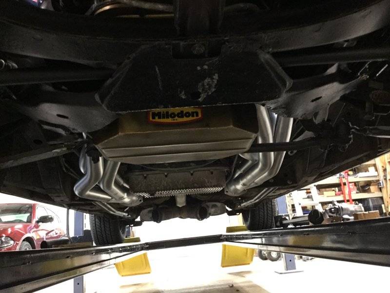

Have Doug's on my 65 with 383. I went with them because they do not hang down.
They have had some minor clearance issues but they make a good header.
