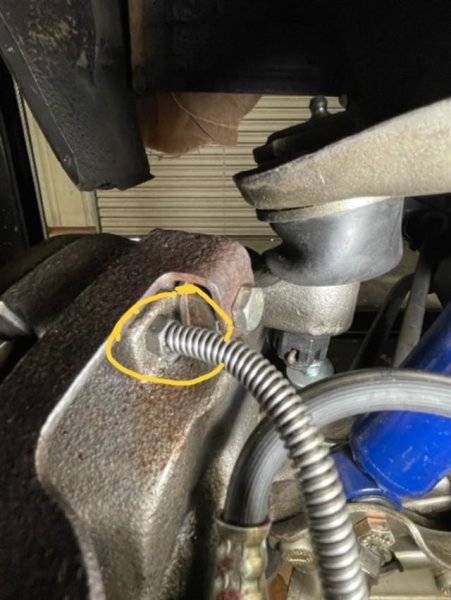

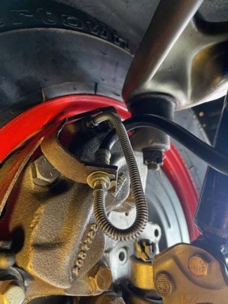

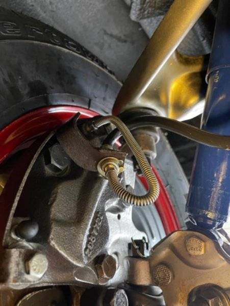

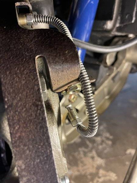

I hear your frustration with the front disc brakes. On my 67 Charger, I did buy the master cylinder and booster fron Dr Diff. At the time ( 2 yrs ago) he was very helpful by phone and email. I had my original Bendix 4 piston calipers rebuilt by Calipers Online, very easy to talk with and great customer service. My problem has been the brake lines for the front disc caliper. The front left caliper brake line will not seat correctly. I have bought new lines, bent by in-lines and a set from Classic tube. On the Classic Tube lines, I returned them as they were too short and did not fit. They rebent me a set to my specs and the passenger side fit but the driver side still leaked. I then was introduced on this Forum with a washer that was supposed to seal the caliper brake line. I bought a bag of 10, they are so small you can barely hold one to get it into the cavity or onto the end of the brake line with grease. After trying several times, my front left disc brake line leaks. I just bought a new set of calipers hoping that the caliper brake lines seats well and does not leak And with regard to bending my own, I did that too. Bought at least 3 bending tools and never once was able to make the bend correctly. It has been a nightmare for 2 years. Very frustrating.

My Charger has the 4 piston Bendix calipers and they are different than yours. I have a back-up set of calipers and yesterday I removed the driver side caliper and replaced with the newly refurbished caliper. The top of the caliper brake line still leaked with my new brake line that came with my kit. I have bought three (3) brake lines and even sent back one to have it rebent to the correct size. After the line was leaking I went to the auto store and bought a brake line and made the bends just to see if it would still leak and it did. I don't understand why this driver side brake line will not seat securely to my Bendix caliper. The passenger side is perfectly fine and I replaced that one a year ago with a new brake line. Very frustrating!

In the top picture, the yellow circled flare nut, it looks like the hex is seated firmly against the caliper body. I don't see any threads left exposed. Are you sure the flare nut is long enough to actually be compressing the double flare to the seat inside the caliper? The bottom picture does show some exposed threads. Are these pics both of the same line at different times?
@Big Bad Dad has a point. Another could be that after 3 brake lines, it's not the brake lines, it's the seat on the caliper that is bad.
I installed the same line on two different calipers. I had bought a second set of calipers for future needs. When the first caliper leaked at the top, I installed the second caliper and the nut threaded all the way in. I wrote to Cass (Dr Diff) and he questioned the same observation. He sent me an email this morning with a picture of the correct lines (#RFB 6850) I need, see photo. I went to his website to order but could not find this part number so I wrote him again to ask how to purchase.

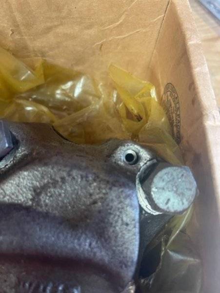

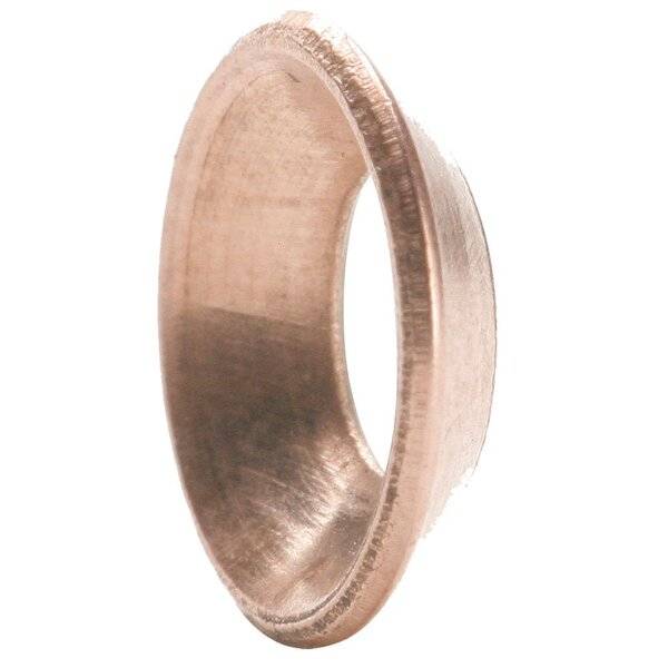

Yes I agree, I thought it might be the caliper seat BUT I have a second set of new calipers that I installed and it still leaked. I have taken a photo of the seat and attached. I even tried another Forum member recommendation to install a Parker 2GF-3 washer, see attached photo, and it still leaked. I hope I can find a pair of the brake lines dr Diff says I need.
