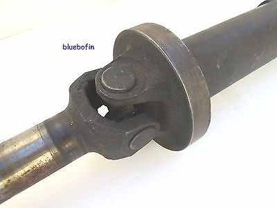

Also make sure your drive shaft is installed correctly. I drove my car for years with the drive shaft in backwards, small end forward and large end on the diff, not realizing it was wrong and I had a strange vibration at one certain speed. When I rebuilt the car, I had the drive shaft rebalanced, and no vibrations.
If you saw an out of round condition on one of the tires, that's where you should start. If it still does it on jackstands, that eliminates the front wheels, and suspension.
im not sure what you mean "small End" both sides use the same size u-joint. the large round counterbalance is at the transmission. isn't that where it should be?
You're good...
