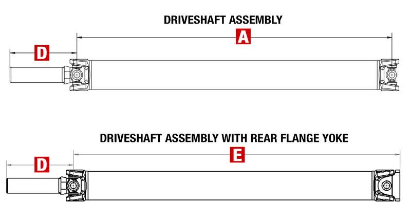

Hi guys. Life got in the way for a moment, but i finally put my yoke on, with approx 1/2" - 3/4" from bottoming out, and measured center to center. I measure only 50 1/2". Is this because my yoke is too long ? Should i find a shorter yoke ?
How are you measuring? 52.07" center to center ("A" below) is correct for your car.

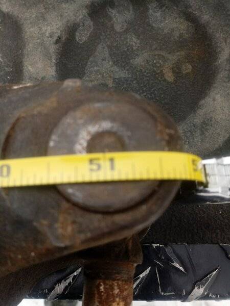

Here is a pic the guy sent. This is from a 69 superbee 383/ 727. Rear unknown. It measures just over 51" center to center.
