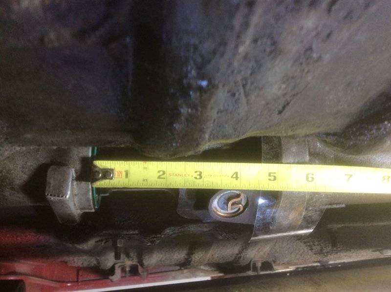

Note I have a short dust seal, the trans output shaft comes out of the trans. It's at 1" on tape measure. Picture is with weigh on rear wheels. If you have more showing try moving yoke up and down,if you have more than 4 or 5 thousands might be Vibe.

Note I have a short dust seal, the trans output shaft comes out of the trans. It's at 1" on tape measure. Picture is with weigh on rear wheels. If you have more showing try moving yoke up and down,if you have more than 4 or 5 thousands might be Vibe.View attachment 1691283
Thanks for this. I saw your picture when I was poking around for this earlier this morning. You basically have less than 2" from the seal to the collar on the yoke. I'll check again and try to get a picture with the car on the ground, but my recollection is that my yoke is much more extended... I'm thinking that I may have the drive shaft from the original 904 when the car was an automatic (??)..and I'm guessing it might be shorter than a correct 833 driveshaft. The tranny is correct for a '66 B body including the tail housing and I rebuilt it prior to putting it back up... Lemme check...

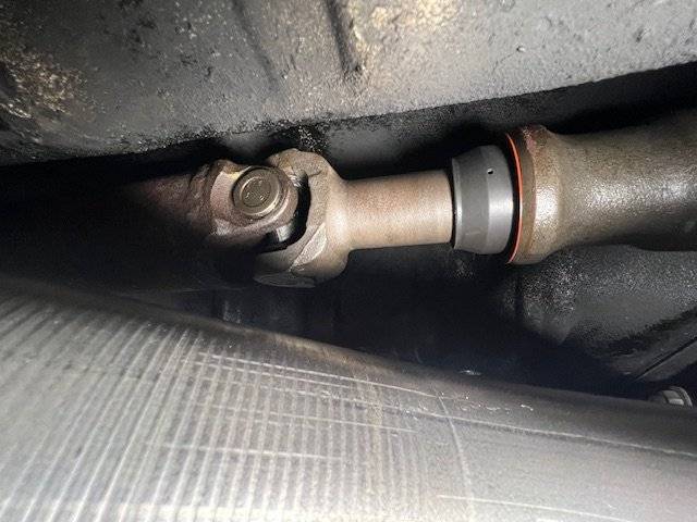

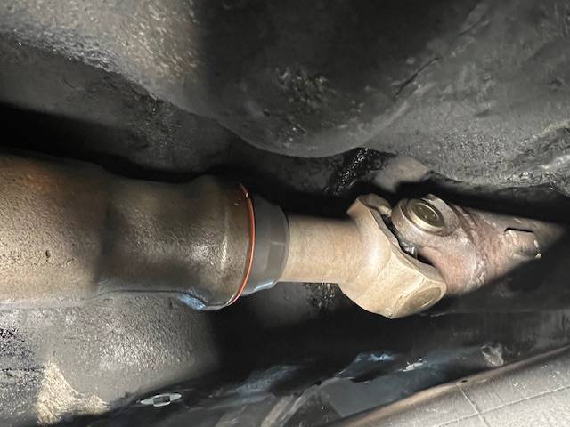

Think I found it... See the pix. The car is on the ground and 2 1/2"+ of yoke is exposed. Also, see the front universal looks like it is separating..one side is further out than the other. That will really mess things up...??
