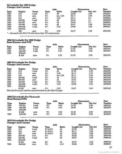

going from 83/4 to a dana , the shaft is 1 1/8in shorter, according to the parts book. an also what I found changing mine.

That's interesting: the Dana 60 driveshafts have a different length between Charger/Coronets and Satellites/RRs/GTX - 50.96 vs. 50.39 - That's a 9/16" difference. I though that the frame/floor dimensions were the same.
Anyways, thanks for the replies so far! Anyone else who found the 1 1/8" difference from the parts book to be accurate?
Wheel base is an inch longer on Dodges.
