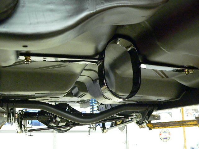

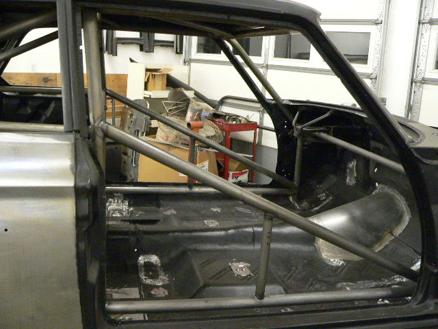

What I do is trim the long legs from the loop. I take the trimmed parts and use those above the floor. Now that the 90* legs are cut off the loop it is welded to the side braces for a cleaner install. Tack weld bolts into the cut off pieces. Then drop them through the drilled holes in the floor. That way you can unbolt the loop w/o removing the carpet to hold the bolts with a wrench. You can see the plates on the floor in the second picture. On mine one additional bolt that holds each side of the loop also mounts the seat (not yet installed).
