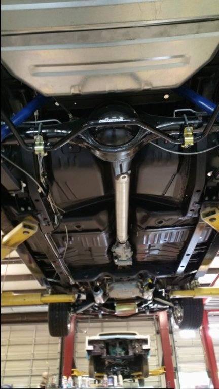

Need some advice I'm working on my son Demon just got done doing a complete Hoskins suspension and Firm feel torsion bars And gear box we added a 8 3/4 now here's the problem drive shaft is 1 inch to long can you cut the slip yolk 1inch are should I just have the drive shaft shortened up thanks for any info. KB9GIB southern Illinois.
It cost about 100 dollars to shorten a driveshaft and re-balance, last one done.
Dennys does a great job for a High quality drive shaft
The yoke has an internal stop, so cutting it does nothing. Get the drive shaft shortened and rebalanced, you'll be money and headaches ahead.
Ok on shortening the drive shaft that's what I figured. That car is really a Demon. Thanks for all your replys KB9GIB.
