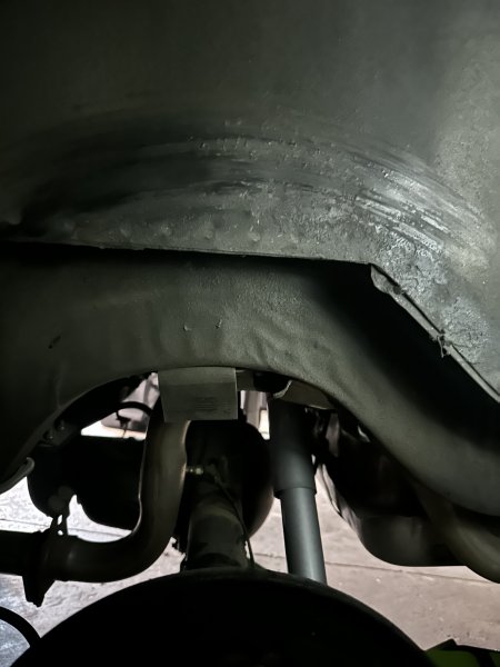

Drivers side rear tire rubbing inner fender when cornering.

What would cause this? Bearings? Weak leafs? Doesn’t feel like any play in rear axle.
Wouldn’t it do it on both sides? And why only when cornering?

Springs are definitely worn. Bushings don’t look bad. All are being replaced. 275/60R15. Magnum 500’s
I had the same problem with my 1967 R/T, which has notoriously tight wheel wells. I installed a rear sway bar, and that solved the problem.
What is the offset on the wheel ? 275/60-15 tires are an easy fit on a b-body. I've actually seen a 305 fit with the proper offset on a b-body.
I have known several people over the years who simply put a set of large washers or spacers behind the wheel. They also make solid "doughnut" aluminum spacers in various thicknesses you could try. I think the inside clearance is easier to deal with than rubbing on the outer wheel lip. Good Luck!

The axle can and will shift side to side during cornering if the bushings and/or springs are worn.

1969 Plymouth Road Runner, 8 3/4 rear end, 383, 4 speed
Check back spacing and tire size. Seems odd one side dose this and the other dose not. Put those new springs on then check it!!!!
It is not unusual to find more tire clearance on one side of the car than on the other, with Mopars. I believe I have one of those aluminium spacers on one side of my R/T.
I have a finger width of clearance on one side and less on the other. It's pretty normal that there is more clearance on one side than the other.
I run the same wheels and tires on my '68 GTX with no issues. I can barely get a hand w/sponge between
tire and wheel lip (cleaning tires). It'll take a 295 pretty easily too.
It's not unusual for a rear axle to not be perfectly centered in a car; not only that, the weight shift when
cornering will not only put the outer wheel lip closer to the widest part of the tire (the "bulge" in the sidewall)
but the tire itself will bulge more as the weight is shifted onto it.
If you go to a spacer make sure your wheel studs are long enough. I'd come back here with pictures and measurements. Wouldn't want something to go wrong, like a wheel loosening up.
