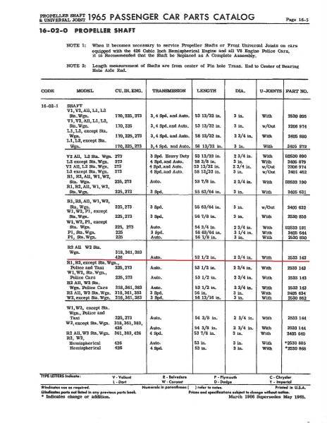

Who has a 65 Plymouth satellite ,big block ,727 trans. ,742 diff . need the measurement from center of u-joint hole to center of other u-joint hole on driveshaft . Yes ,I look at the sticky on driveshaft length , don't list 65 on down . Thanks
Here is the driveshaft lengths from the 65 parts book.
