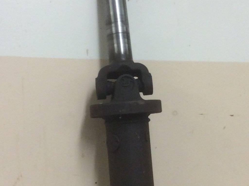

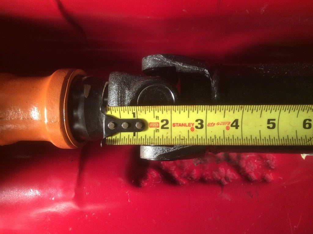

I was mistaken, it's the shape that fooled me, notice it's rounded the 1350 is square where u-joint mounts. I took the measurement on 1350 yoke, pic 2 measured 1330 shaft pic 1 so close to 1.5" didn't bother to put tape measure in pic.
There is maybe an 1/8" difference.
The measurement you are depicting in your picture is doesn't matter at all. Drive shaft length is measured by center of front U joint to center of rear U joint after you bottom the front slip yoke into the trans (including crushing the outer dust seal), then pulling the slip yoke back out 1.25 inches. That's when you measure CC between front u joint & rear U joint.
Driveshaft length doesn't care which style of u joint you use, 7290, 1330, 1350.
