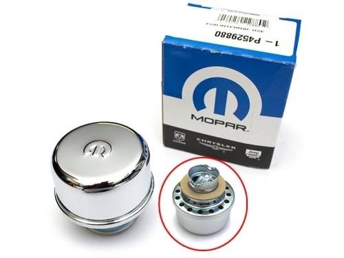

I'd also doubt that the breather cap is restrictive if you are using something like this.

I'd also doubt that the breather cap is restrictive if you are using something like this.​
The one I'm using has a hose connection to the bottom of the air filter housing. I don't use the original housing anymore, use a Edelbrock instead with no hose connected. The diameter of the hose fitting is 1/2" while the bottom opening of the breather is 1". The one you show above seems to have a combined area that's much greater than 1/2". It was the hose nipple fitting that made me think the breather cap was being restrictive at highway speeds, 65-70mph. Thanks for the tip, I'll certainly try that kind of breather.​
