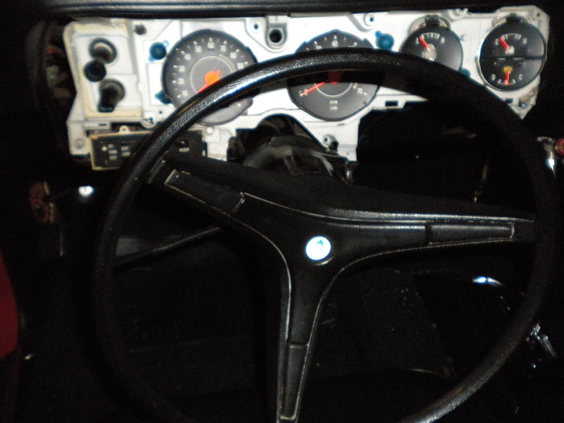

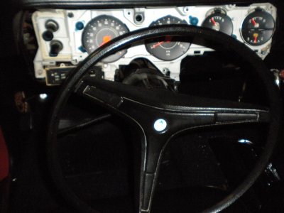

The guys here told me how to drop my steering wheel...just like they said loosen the nuts and she'll drop down...I had to give my 73 RR a little nudge but it was cool to do...gave me lots of room when I redid my cluster.:snorting:...Marla
