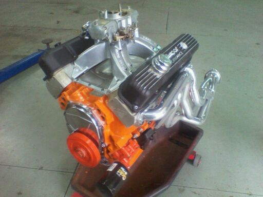

The way I bought it
1969 Dodge Charger SE
383 Magnum
727
3.23 open 8 3/4 - 489
PS/MB
The way it is
1969 Dodge Charger "The Duke"
440HP '72
10.5:1 Mopar Pistons @.030 (446 c.i.)
Edelbrock Performer Heads
Hughes Solid Lifter Cam 278/283 240/250 .565. 575 108
7Qt Oil Pan
Victor Jr intake
Edelbrock Thunder AVS Carb @ 800cfm
TTI Headers 2" Primaries
727 Manual Valve Body
9" Dynamic Converter
4.10 Posi 8 3/4 - 489
3" Dual Super 44
Coys 18x9 20x10.5 Cragar 15x8 15x10
