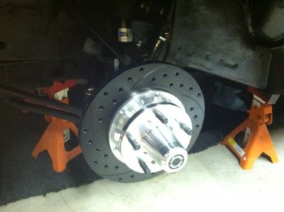

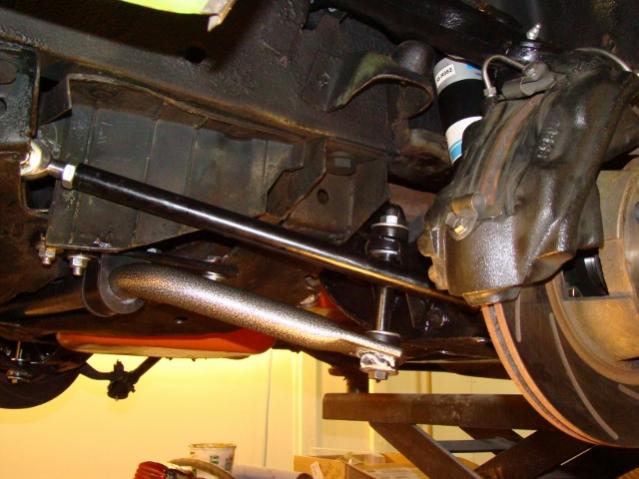

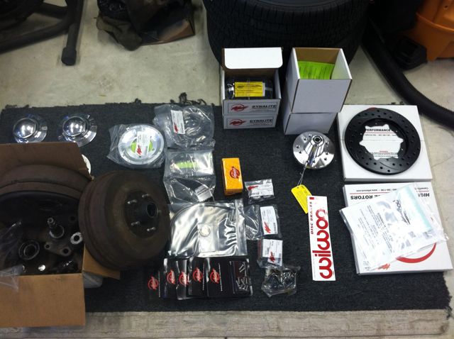

Hey Guys,

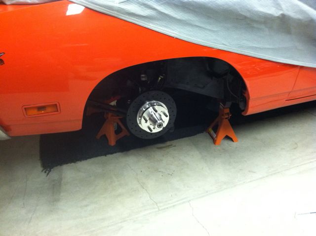

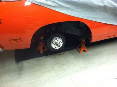

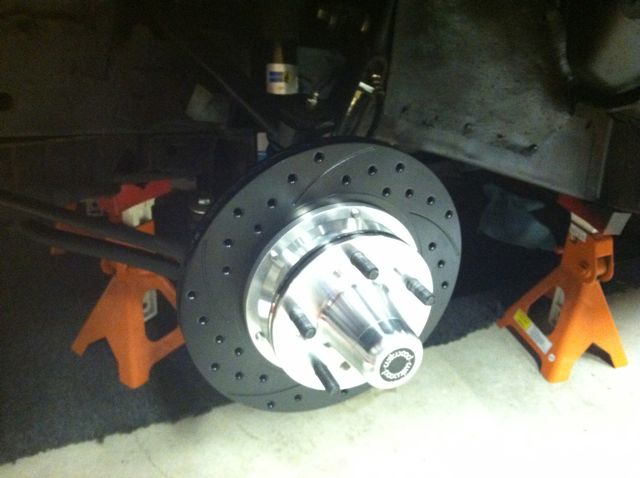

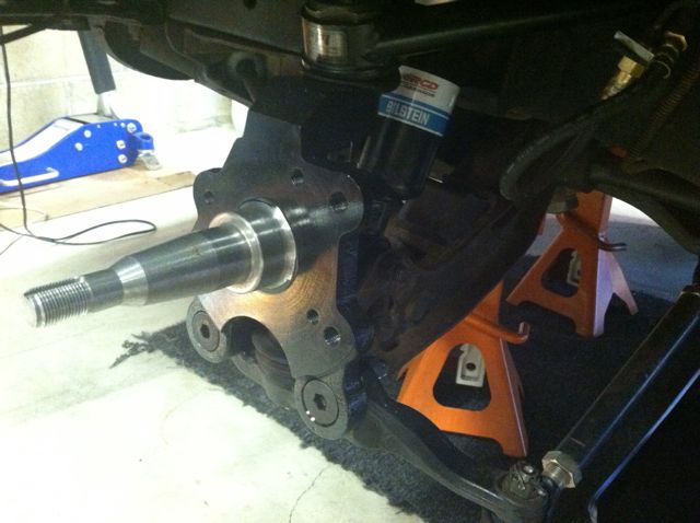

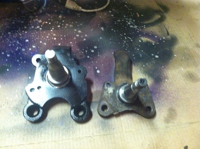

This is a Wilwood 11" drilled and slotted kit from Magnum Force, which also supplied the 2" dropped spindles I used. Their spindles give a 2" drop and in addition use the '73 and later "big bearing" style of hub/bearing. They are mounted on Firm Feel upper control arms and stock lower arms, with Firm Feel ball joints. BTW take a look at the Magnum Force spindles compared to the stock - think those will take a load better!
I must say of the Magnum Force folks: Their ability and willingness to talk to me on the phone and help me get the right kit (Wilwood has HUNDREDS of part numbers) was second to none. They know their stuff. And the kit they provided was incredibly complete - right down to the cotter pins. But for Red Locktite and a giant Torx bit, I didn't need to leave my garage for a single "missing" part, and the quality of the machined parts is gorgeous. It made the install really fun.
Two words of warning: 1.) The caliper adapters are hard to tell apart and can be mounted both upside down and backwards! Ask me how I know. The "nutsert" in the adapter has to be facing the right way given the direction that the caliper bolts go. That is not mentioned in the instructions and is hard to see in the photo if you don't know you should be looking for it.
2.) 2" inches may make it a challenge to get your car out of your driveway. In fact, you may not be able to get it out at all! I had to tighten up my torsion bars and get the car re-aligned in order to make the break-over on my driveway. That was close!

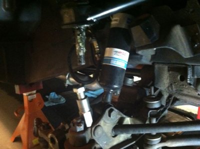

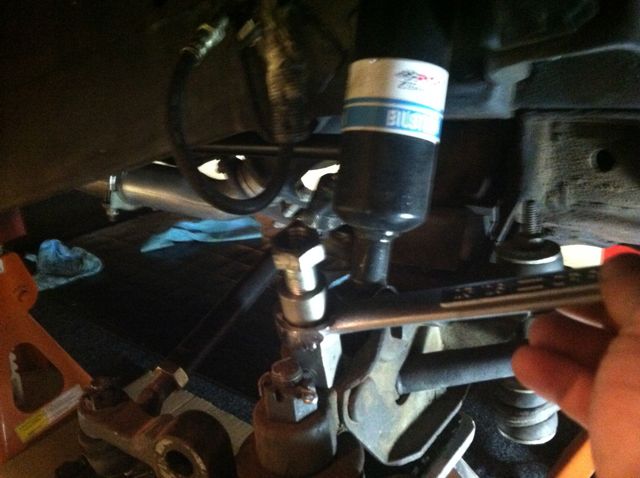

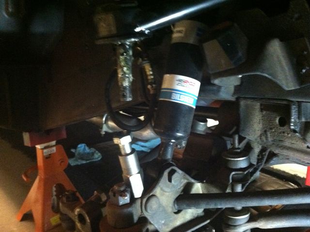

For a couple of guys who asked questions: These photos show me using the Mancini Racing Ball Joint Separator Tool to remove the spindle from the upper ball joint. This is obviously done with the spindle still attached to the ball joint at the top, but also to the lower control arm at the bottom. Force between the lower control arm and the tip of the threaded section of the ball joint forces the ball joint taper out of the top of the spindle.
I have the spindle off in the photo so that you can see how I placed the tool. The recessed tip of the tool was up against the threaded ball joint prior to the taper releasing. I wedged the large lower portion of the tool in the space you see at the LCA, and then turned the "bolt" portion of the tool with a box wrench which I had slipped onto the tool before the tool was "unthreaded" up to the ball joint. I used a box wrench rather than an open end wrench because the amount of force required is substantial. So substantial that when I got the tool tight, I put on heavy gloves and got my head and face out of the way outside the fender well as I "unthreaded" the tool to make it tighter and tighter. As I turned the tool each time, it was easy to slide the box wrench down the shaft of the tool, readjust its position, and take another turn.
It was exciting when it let go - bang! - but none of the parts moved any significant amount. No danger, just excitement. BTW I supported the LCA with a floor jack so that it wouldn't slam downward upon release, since the torsion bar is held in tension by the upper bump stop under the UCA, which won't hold it once the upper ball joint is released. As you know, the LCA is the only place there's any load on the suspension - the UCA just rotates freely once released from the LCA.
