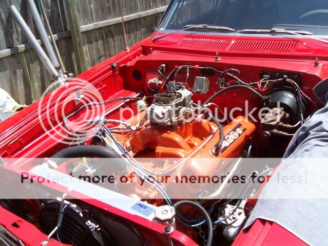

Mine is for a 67 B-body car. You definetly want to go with a dual M/C. Your life is worth it. You can see mine here and it needs to be painted before I put it in that indoor car show I was invited too. Ron
