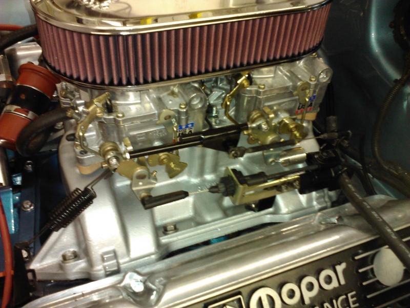

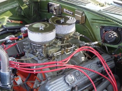

whats the best way to connect throttle linkage. needs to extend about three inches. thanks, bob IMGP0150.jpg

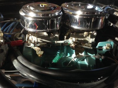

here's a mock-up pic of how i did the linkage on my quads.

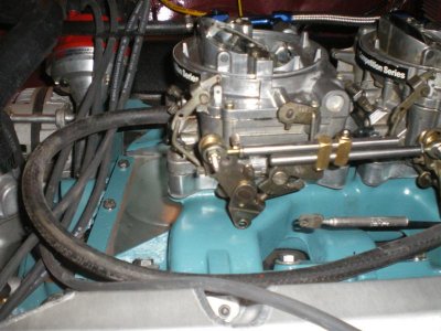

Here's a picture of my set-up. The rear carb is the primary and includes an electric choke. The link between the two carbs is a street hemi piece. The difference in pivot points brings the front carb on progressively and is set so both carbs are wide open at the same time. This is basically the way stock street hemis were set-up. Some of the linkage brackets came from here: http://dynamicrenovation.net/viewcategory.php?groupid=02 X 4.jpg
Already been shown, but primary carb is in the rear.
steve, someone said six cylinder was longer

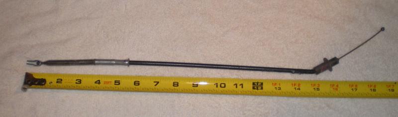

thx to all, got my cable out, I need one 3 to 4 inches shorter, if anyone has one...thanks, BobIMGP0165.jpg

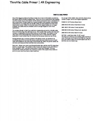

Here are the factory cable lengths so you know what to look for:

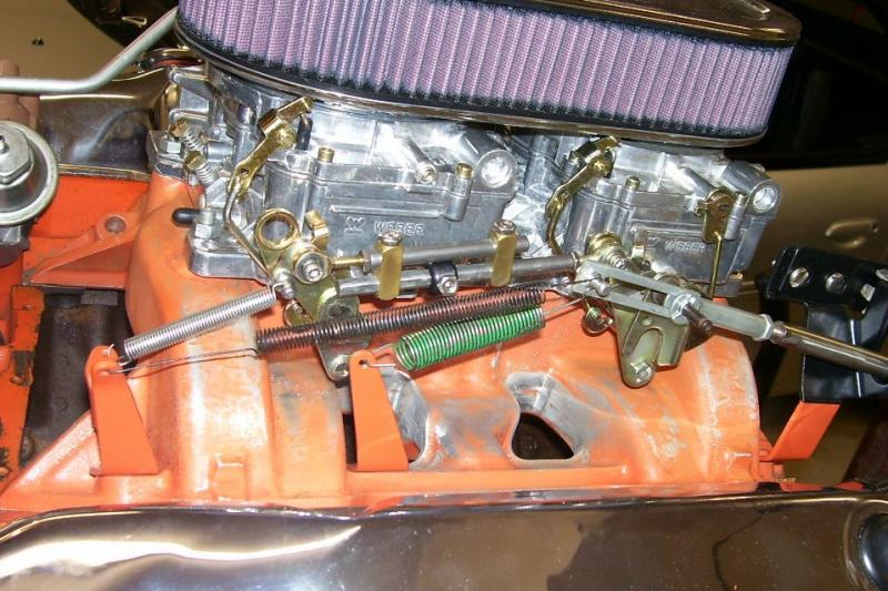

I modified the progressive linkage since I feel the dual quads work better with 1:1. So I put it together this way, I think it looks and works better. WP_001690.jpg
