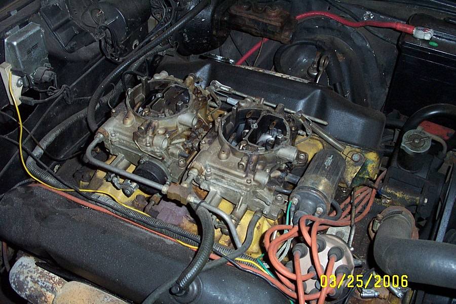

I got dual quads on my 66 383 Charger....I'm running the stock throttle cable. Made my own baseplate out of aluminum so I could run stock Fram CA137 air cleaner element.

yea..it's a factory cast iron 343hp intake, 1961 I think. And yes, Hemi base plate will not fit. I have a tubing cutter & bender, made my own lines from fuel pump to carbs. I also have my carbs linked together, not progressive linkage. I didn't have to worry about trans kick down linkage, both my Chargers are 4-spd cars. Carb size I have is pair of 625's on it now. I really never drive the car much....and the set-up has been on there so long, most everyone in Washington knows what's under the hood

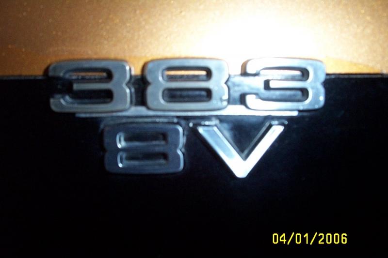

I got one to load...it's my front fender badge I made for the car
Bryan

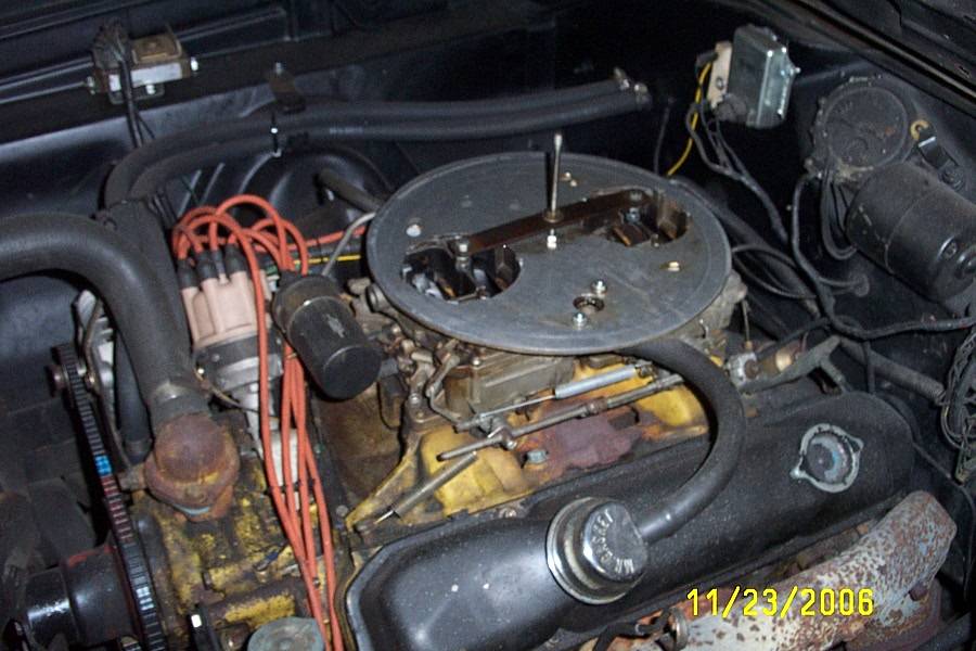

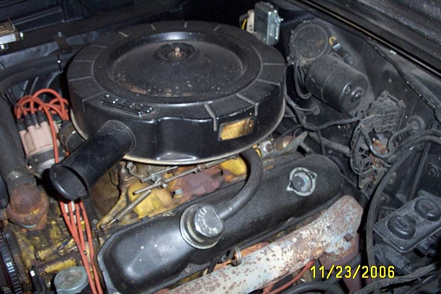

carbs, then home made baseplate, then Fram air filter, then air cleaner top....but before anybody says anything...the baseplate does not extend to the lip of air cleaner top, so it's all open underneath like the unsilenced styles
Bryan

Hey, that's pretty cool! Looks like a 383 2 BBL at first glance. Going with the 1:1 linkage may help if you have fuel distribution issues.
That's a very cool looking set up!I don't want to build a full fledge race car out of this 67.Just a cool looking cruiser with a bunch of wow under the hood like A833Wing has.
