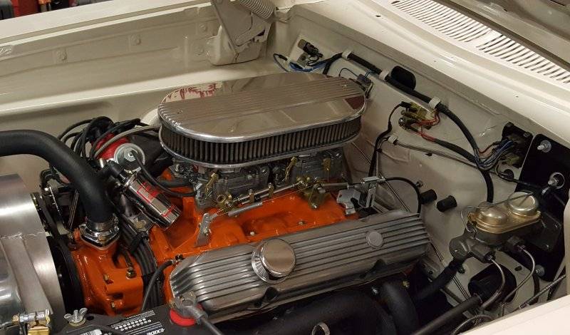

I had a 1962 Chrysler 300H inline 2 X 4 setup on a 426 Street Wedge in a 1964 Polara 500 I used to own. These were original carbs, meant for a dual carb setup: no choke on front (secondary) carb, and choke on rear (primary) carb. These carbs also each had a velocity valve under the secondary venturies to help with transition to WOT. With some jetting experimentation, I got them to run pretty good. However, I never thought they felt as crisp as the single 750 cfm Edelbrock on the 440 in my 1967 R/T. "906" heads on the 440, "452" heads on the 426, and same Mopar Performance "Magnum" cam in both. On the street, I say the large single 4 barrel was the winner, but at the car show, the 2 X 4 setup was clearly the favourite. It always drew a crowd. Maybe on top end, the 2 4's might have an edge, but who drives that way anymore?

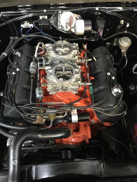

An OEM Dual Quad manifold ever existed for the 383. The only engines that had a Dual Quad manifold were:
1) '55-'59 Various 301, 318, 350, 331, 354, 383 RB, and of course Chrysler 300 Letter Series 392 Hemi engines
2) '59 inline DQ & '60-'64 Chrysler 300 Letter series, '62-'64 Max Wedge engines
3) '64-'70's 426 Hemi
I am unaware of any 'Legit' OEM multi-carb setups after the Hemi with the obvious exception of the 6-Pak 340/440 engines and these can be either cast iron or aluminum depending on year. SuperBee 383's engines ONLY came in a single 4BBL version. The aftermarket: Edelbrock, Offenhauser, Wiand, and even Direct Connection/Mopar Performance might have made a Dual Quad "B" manifold, but the only aftermarket offering I know of is Edelbrock for the "RB" engine.

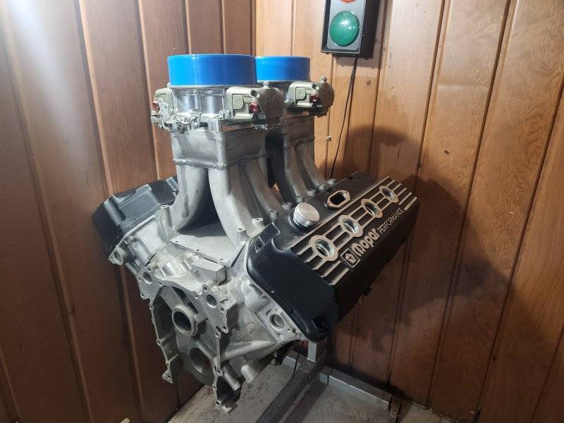

Tunnel ram on a warmed over 383 with aluminium heads beats an 850 Holley on a Performer RPM intake.
Ran this 383 with the single 850, tunnel ram with 390s, 600s, then efi.
Tunnel ram with 600s on a stock rebuilt 383 hp engine, 850 a bit better.
I wouldn't bother with a low and slow dual quad on a 383.
The only dual intake manifold for a 383 is the Weiand tunnel ram, imo.
