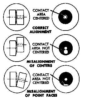

I doubt very much that you can really find a quality set of points these days. The best I ever had in the past was BlueStreak brand. Hall those buggers out and under magnification see if the contacts are precisely parallel. If not, toss them. See how much spring pressure they have by manually moving the arm away and letting it go. If the contacts do not line up perfect, and tend to be on the heel of the contacts they're trash. If the shaft for the distributor has lateral play, you'll never get ideal gap or dwell. This is why so many people have opted for electronic style pickups as opposed to points. China will be glad you stuck with points cause there ain't nobody here that makes them.
