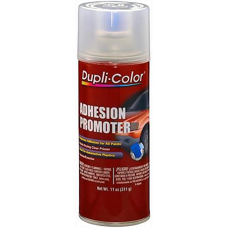

Use this stuff before you paint

I have used the adhesion promoter that was mentioned above and it does help but the main thing is just making sure the parts you are going to coat are CLEAN.
