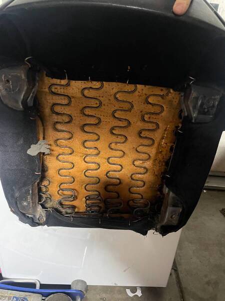

Hello everyone,
I am looking to buy some bucket seats without seat tracks for my 71 Charger.
They are for 71-74 B-bodies. I was told by some forum members that seats like these with no tracks are worth $200-$250.
The problem is that I cannot find any new or used seat tracks for 71-74 B body cars. I bet they are expensive used as well.
I know that 70-74 E-body seat tracks are similar, and OER sells some for $100 each or $200 for the pair.
Will these E-body ones work?
Has anyone done this with their B-body?
I know there is a height difference between B and E body tracks. I do not know of other problems (yet).
Here are the tracks:
Thanks everyone!

Those look like the 70-early 71 seats with the metal hinge covers. The hinge covers sell for 200-300.00 set. The seats go for up wards of 500.00
B/E use the same seats and floor pan. I've use E-body tracks in a B-body and they are about an inch shorter.
