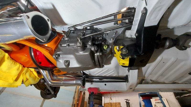

Yes my 74 was originally stock with 318 bench 3 speed manual on the floor. It now has a 4 speed 440. That’s why I asked the question above if the 3 speed and 4 speed humps were the same. When you ordered the RR option that’s what you started with and you could change seats, transmission, motor and more from there. Why somebody would get the RR option and not change the 318 is beyond me. My car wasn’t even optioned with a tachometer. You would think with a manual car, the factory would make a tachometer standard. The only option I can see that was ordered on my car was a sunroof. Unfortunately the fender tag was removed.

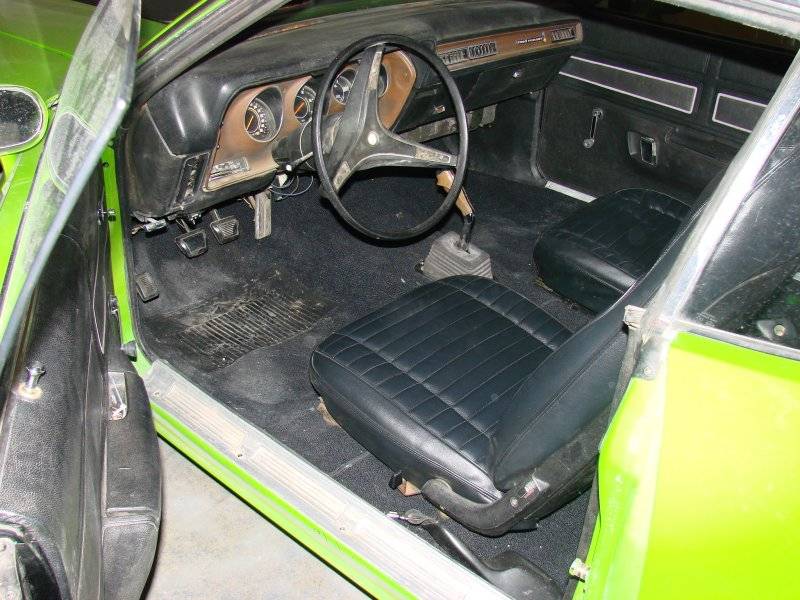

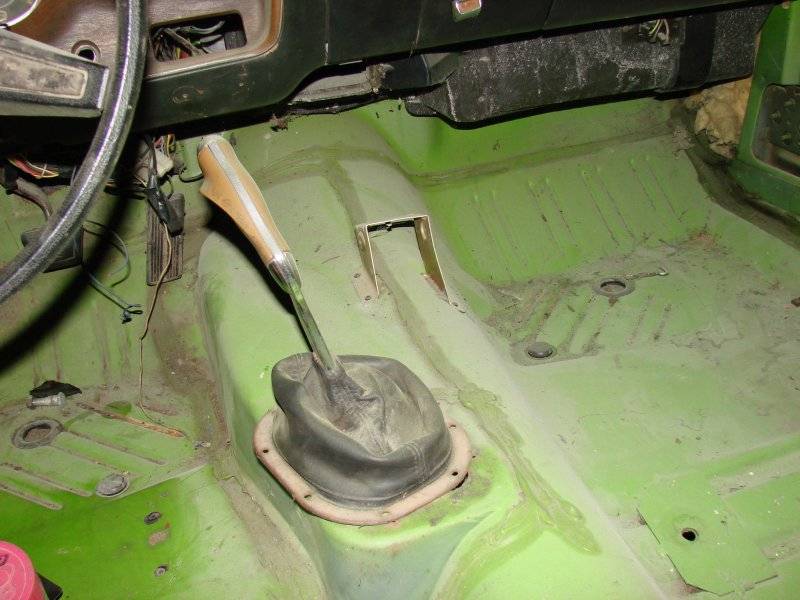

RR Fan Dan - did you have to use the infamous "dog bone" bracket to position the shifter box correctly?
I had to do that on my 71 Runner as mine has the hump for the bench seat set-up even tho I have buckets.
Way back when i ordered the hump from AMD the only one available was for the bench seat set-up.
They now have both styles.
How long ago was that?
When I needed it, all AMD made was the bucket seat hump.
I had to cut out (that was fun) a factory bench hump from a donor car.
