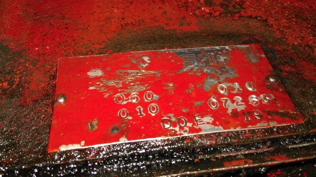

been a while been fighting the big C think i got it whooped missing a lung but thats why god gave you a spare . lol. it was a hard battle glad thats over. here is a picture of the plate. e383. 9 25 2 020 this is front pad under dis.

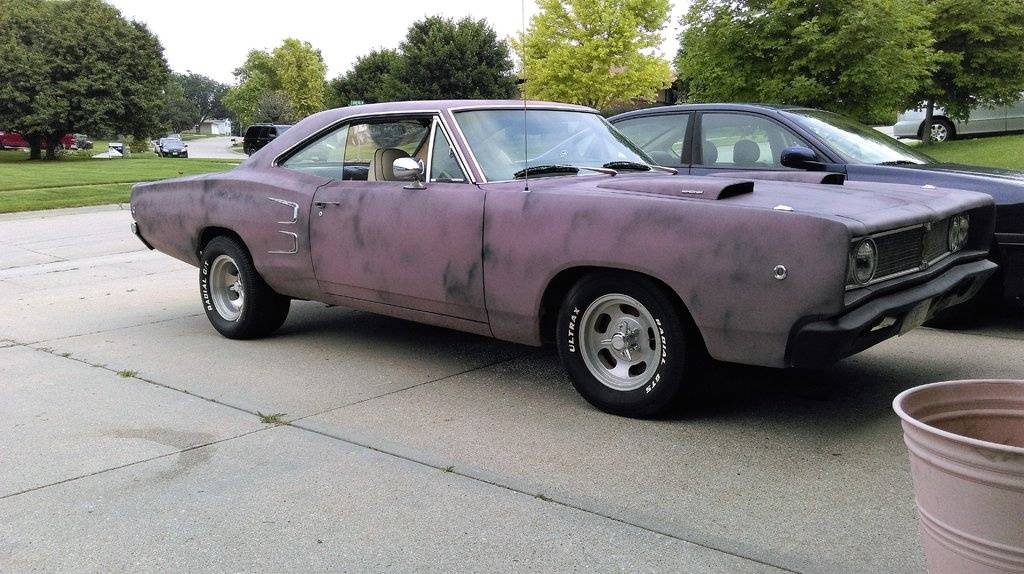

hanks for any help 68 coronet 4gear suregrip plate is left side eng

Rebuild shop spec tag. Motor has 0.060" bores, 0.010" rods, and 0.010 mains. 07263 is probably the job#, and DOE is probably an employee initials. Couldn't guess the 193. If you carefully clean the red paint off of the tag, it looks as if the data is underneath.

i thought so secant guessing my self been awhile im thinking not original eng wanting to cam it up
