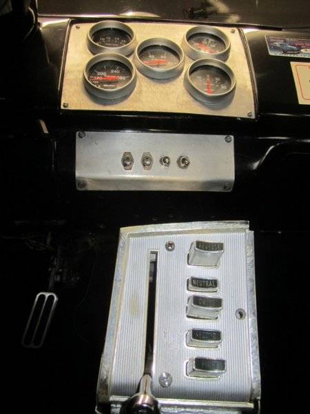

I'm full manual reverse,so I push my own "buttons"

Cool for the track but a full manual valve body in a dash pushbutton car would get old really quick

My heap gets to the track 3 or 4 times a year.In these parts there is a cruise every night of the week and several choices of car shows on the weekends.I drive well over 1000 miles a season and get out out at least 2 or 3 nights a week to hang out.
Manual VB is like a stick,,,,,,you have to shift!
