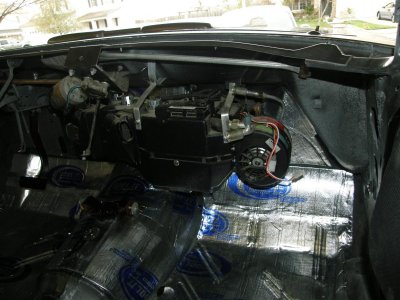

Tossing around the idea of aftermarket air on my '65 Coronet 500 with console and 4 speed. Just air, no heat or defrost. Anybody done an aftermarket setup that doesn't look "tacked on"? I do not have an A/C dash. Sure would like to see some install pics, especially of the dash or underdash part.

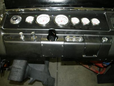

Here is a vintage air system, heat, ac, defrost. Also the dash pics shows the upper outlet vents, and I just recently found some oem ac/heat vents that go under the dash and the passenger side kick panel. This might give ya an idea of how to mount it and what it looks like under the dash.
