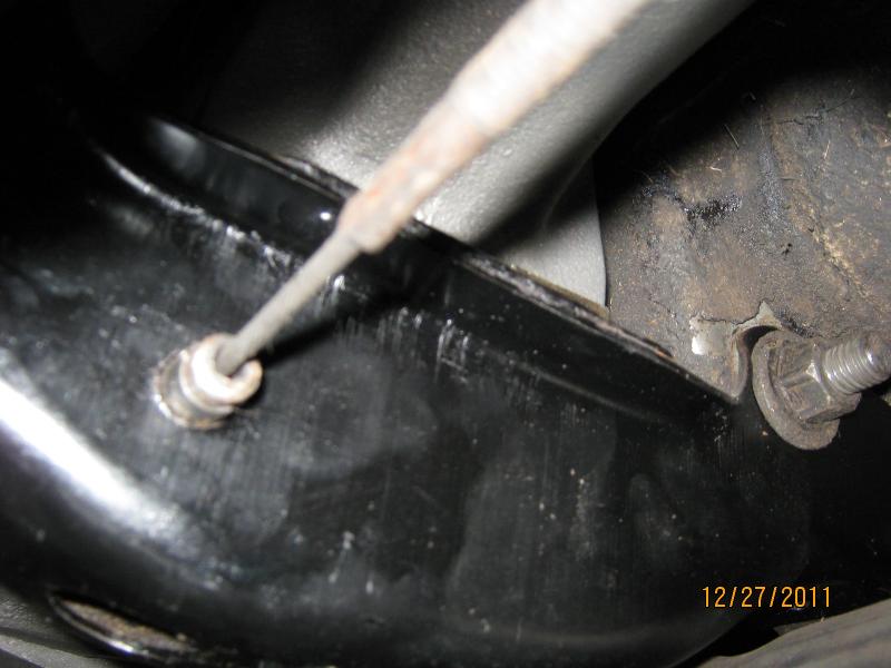

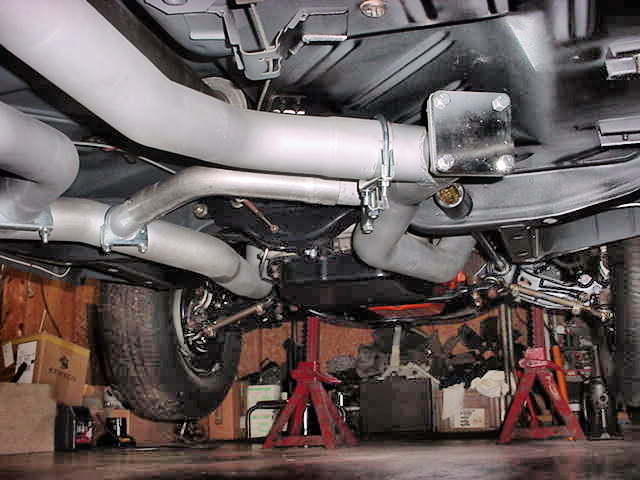

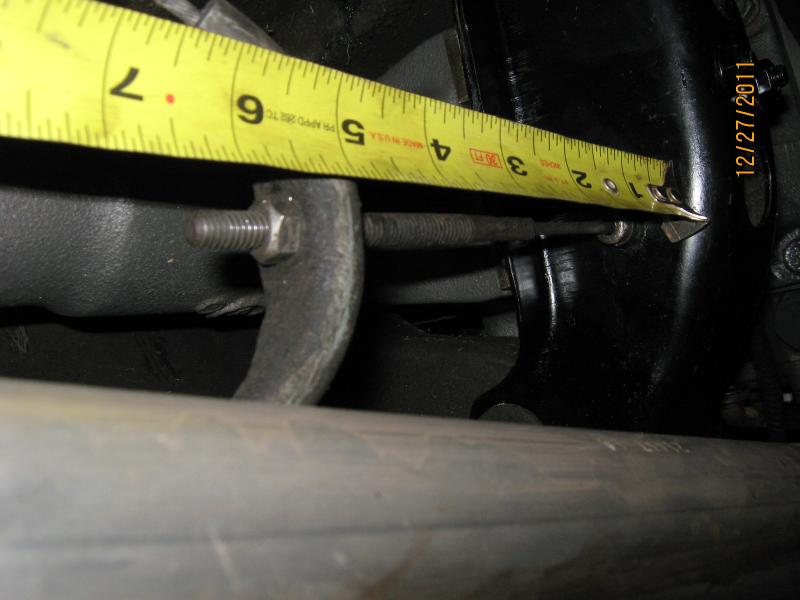

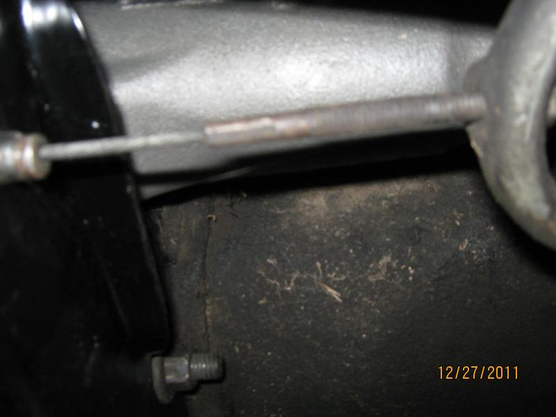

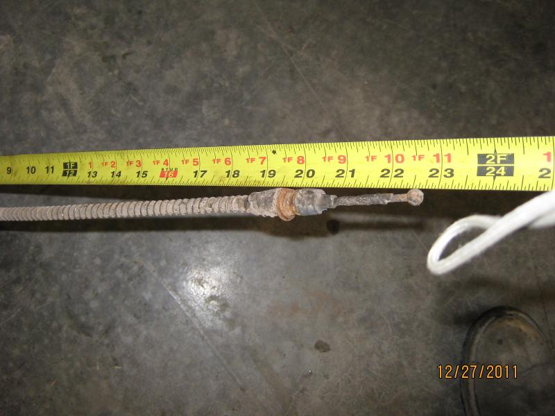

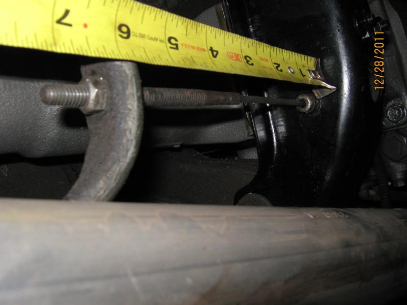

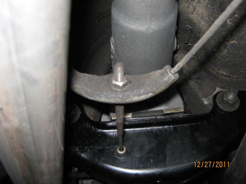

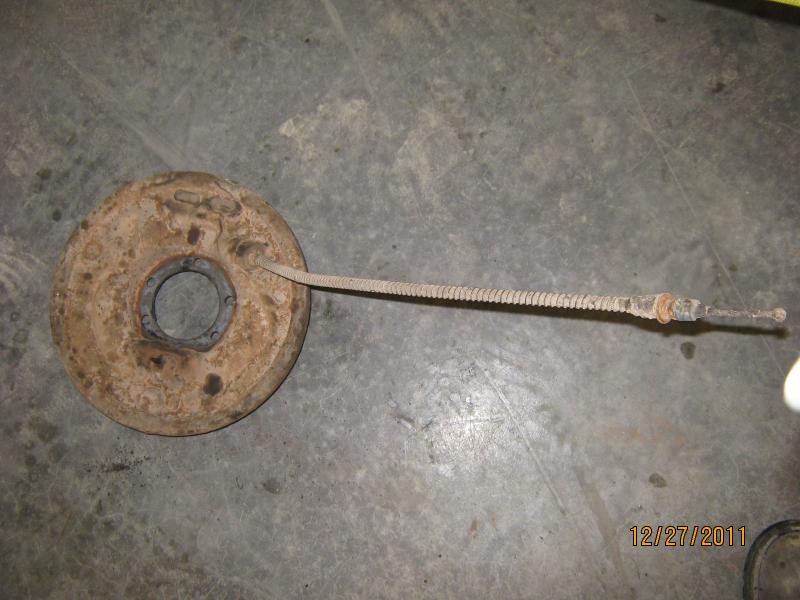

I went out and took some pictures under my 65 coronet. I hope they help. I also had a set of rear brakes from off a 65 coronet in the shop and they still have the E-brake cables on them. They look to both be the same length RH and LH at 22.5" to 22.75" out from the baking plate to the tip of the ball on the end of the cable. Where it would hook to the intermediate cable. Sorry I am sure they are not the best pictures, but I can't do much better with out putting it up on the lift and I have it tied up with a toyota truck at the present. Let me know if you do not get this figured out. I probably have most of the ebrake parts on a 65 that I would part out anyway, as I just pulled the rear out of it.
Matt

Matt,Thanks for the photos,tey are perfect!This looks like I may have two problems:First your front cable is 1-1/2 to 2" exposed between the rear fitting and adjuster threads,mine is only 1/2".Second your equalizer connection is 5" from the crossmember,mine is about 7" away from it. I'll have to get some more measurements tomorrow in the daylight,maybe it will be dry too!Is your brake applied or released in the photos?
Thanks,RT

Those pictures are with the E-brake pressed down. So I would have been wrong, that is why I like to check to make sure as my memory is not that sharp at times. I can try to get a few pictures with it released this afternoon.
Matt

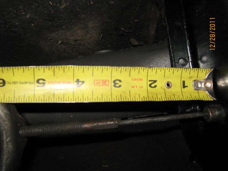

Here are a couple pictures that i went out and took this afternoon. The E-brake is OFF this time. So this might give you a better idea about the cable. Hope this helps you out.
Matt

Matt,Looks like 2-1/2" exposed cable ,no way will this new cable work with only 1/2" cable exposed on mine.Even if it did reach yhe equalizer,ther would not be enough travel to apply the brake.I may have to find a used cable or hit the parts store catalog for something close.Thanks for more photos,you are going above and beyond!
RT
