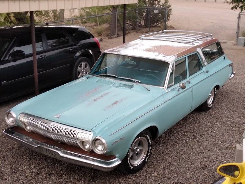

Planning to swap my 318 Poly to an RB in the future.
Will I need a different K-member? Also want to keep pushbutton trans. What year BB trans will work with my cables?
Just need mounts and inserts. I think 63 and 64 would work for trans. 65 would need drive shaft and some changes in trans.
You can swap the poly push button case with a big block case. And retain all your existing drive train. Very easy swap.
