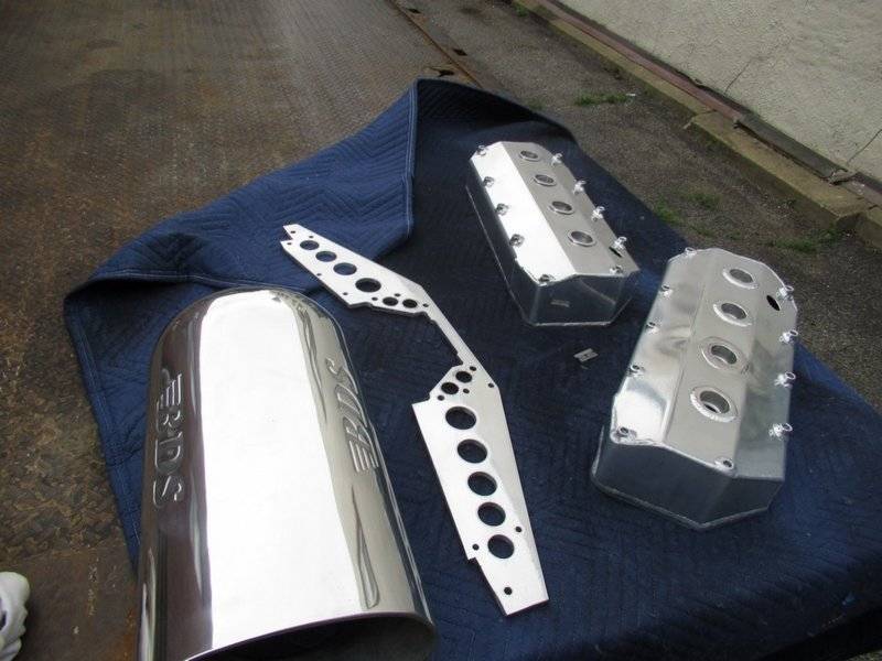

I might suggest that mods you do,,,make it as light as possible.Ounces add up to lbs!
