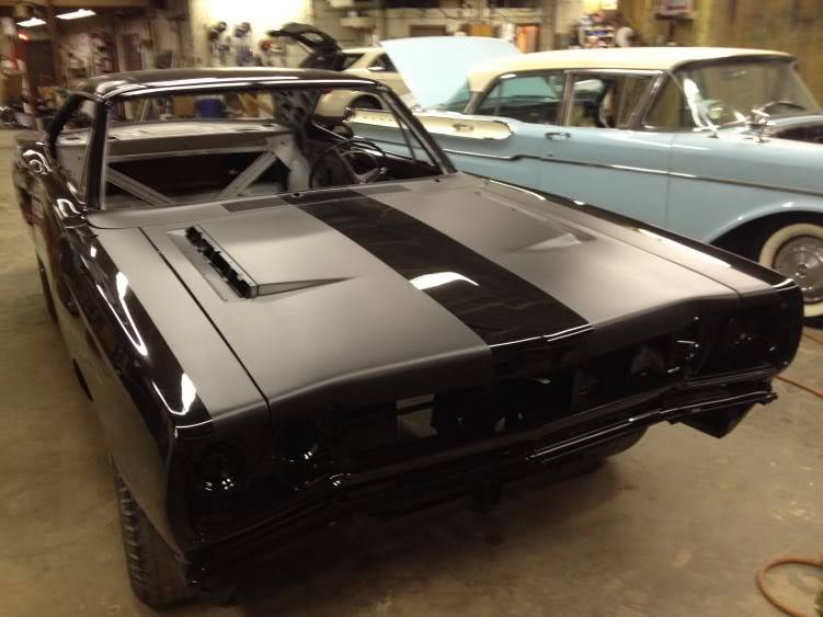

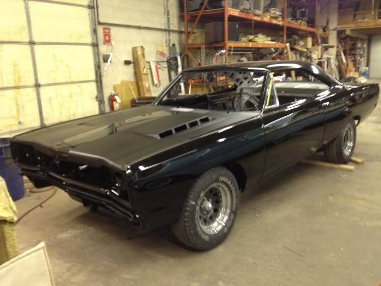

This is my roadrunner with the PST 1.030" bars in it. There is no driveline in it. The front tires have about 1.5" less diameter in the front than the rear. The torsion bar adjusting bolts are about 3/4 the way out.
Take what you want from it. As for now the PST seem like they're gonna work out fine for me
Prop, that looks badass! kinda has a "Mad Max" quality about it with those wheels and tires and I really like the flat black stripes on the black!!!! Tommy, did your car sit like Prop's????

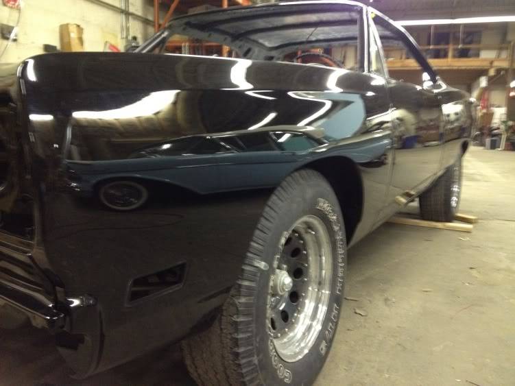

Thanks Green......The rims and tires are rollers. I don't know if you can tell but there is Wranglers on the front...lol The actual wheels to go on are going to be Coy's with the Charcoal paint and machined aluminum outer lip.
Here's another shot of the stripes....Seems a lot of folks dig'em
