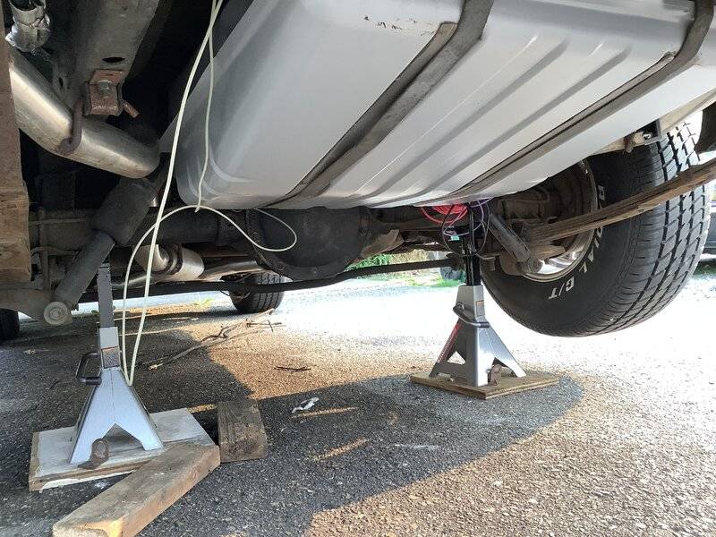

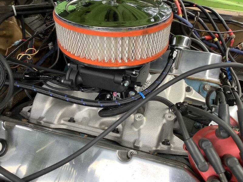

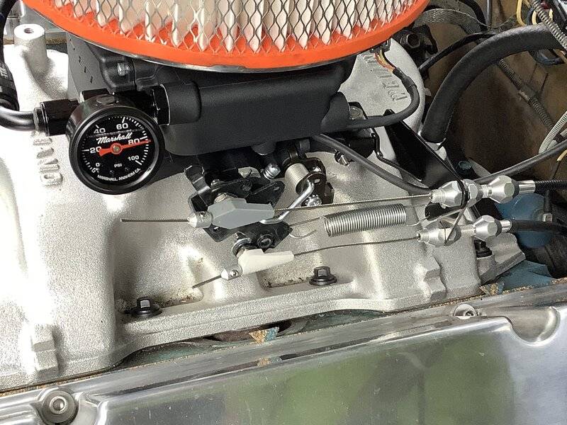

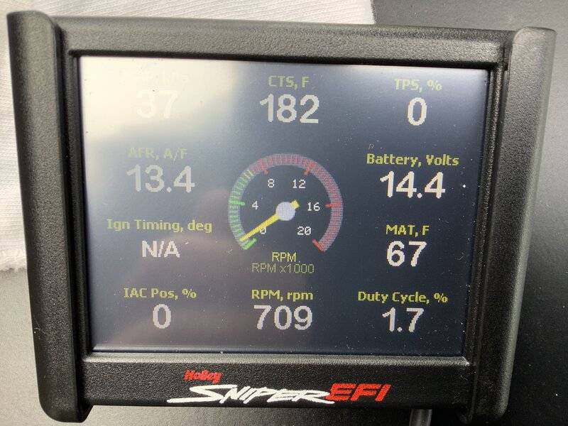

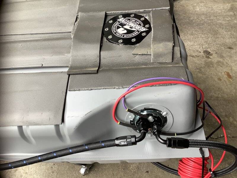

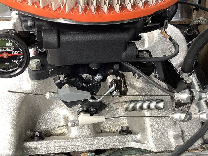

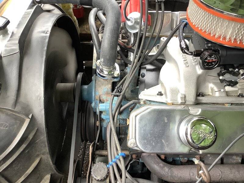

I recently installed the Sniper system on my 74 Charger with a 400 that’s pretty much stock internally. I spent considerable time researching and looking at the best way to literally replace the entire fuel system and then install the efi.
I went with a complete efi tank for a 71-72 Charger along with a 10 micron filter right off the tank and ran new fuel lines up to the firewall. The sniper efi was pretty straight forward to install and also converted to lokar cables for throttle and kick down.
I drive this car a lot and Seattle is known for traffic congestion.
As stated already here starting is simply waiting for the handheld to load and turn the key. So far for me this has been worth the investment. Nothing was wrong with the Edelbrock that was removed. The original tank needed replaced anyway.
I did not have any hope for mileage improvement as that’s not reasonable for my car. It’s all about your expectations and how you do the install and clean, clean and clean are a must. Doing the install Yourself is a great experience and you have control over the outcome. Just my opinion and experience and that’s all.
