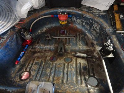

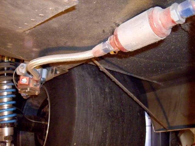

I think this is what Budnicks was talking about on a regular carb.
Mine just happens to be on the right side.
Sorry for the dust.
DSC02889.jpghere is how I choose to mount my Aeromotive S/S pump. the fuel cell has yet to be installed, but this gives a good look. I am sure if you decide to use a cell this may work for your 71 as well.
