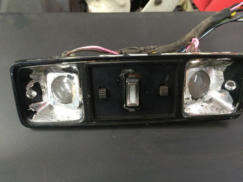

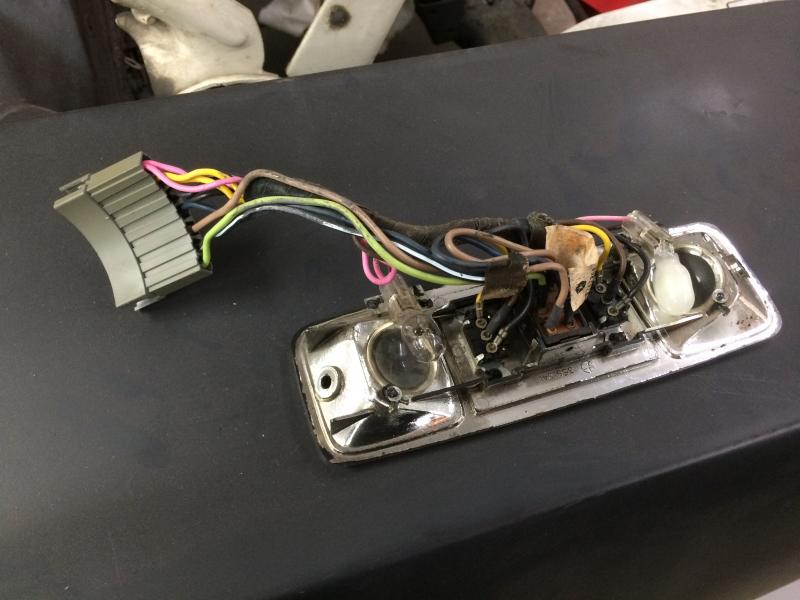

Want to purchase a sun roof control panel for a 75-79 b body or charger, cordoba, magnum C-body will also work. The switch is worn/broken. Switch functions just the same as electric window, but a smaller version. If you have a center off 2 pole double throw that will work for me
I'd bet if you peeked in some older M bodied Mopars (5th Ave's, Diplo's and GFurys) you'd likely find what you need. It's bee so long since I"ve seen a moonroof switch in either that I can't say for sure it's identical, but I'd bet it'd work in a pinch
Maybe take the switch apart, its just contacts in there, clean and adjust em up. my .02
