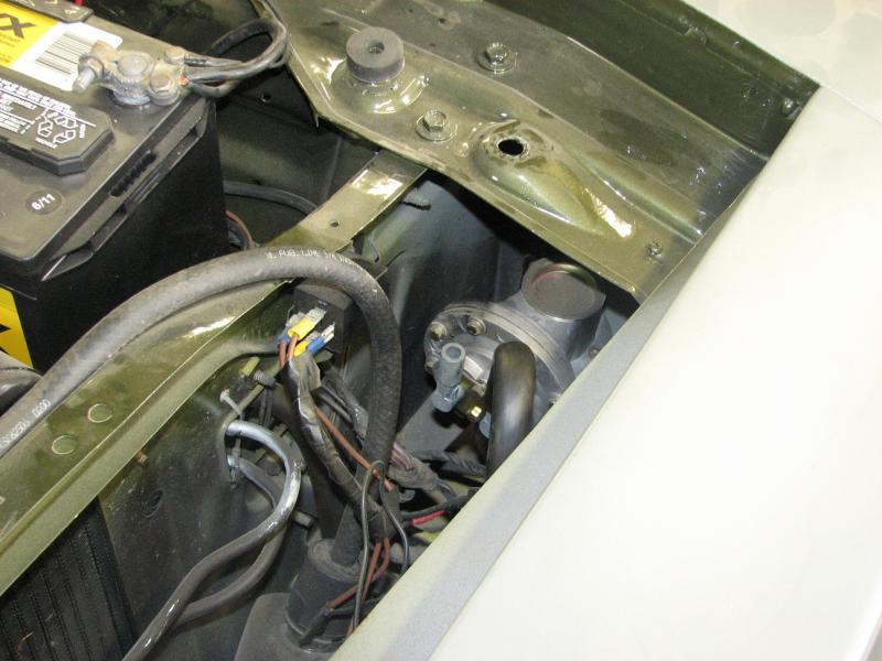

I got this kit from SSBC as well as a vacuum canister which serves as a reservoir for vacuum.
I only have about 100 miles on the kit - and think it will be adequate. With the addition of a vacuum can - I will get a good 2 stops, maybe 3 with some vacuum assist.
Where reliability is an issue however - is the relay. I already had one fail where the small soldered contacts shook loose and therefore the pump motor wouldn't run. Poor quality solders was the primary cause. The pressure switch runs to the relay to turn the pump on when the vacuum runs low.
I have a new relay - but am thinking about putting in an emergency switch and guage where I can directly turn the motor on and bypass the relay.
All told - not an ideal solution so far for me. Based on my experience with it - I kind of wish I had manual brakes!

Use a canister and upgrade the cheap pos relay that comes with the kit to something heavier. The reason the relays fail is because the can is relatively small and with constant use (heavy stop and go traffic) the vacuum level fluctuates quite a bit, causing the pump to short cycle and burning the relay contacts.
You could also get a second vacuum switch set to make at a slightly lower point than the one that controls the pump and use it as a 'low vacuum' alarm with a red light on the dash to alert you that something is wrong.
