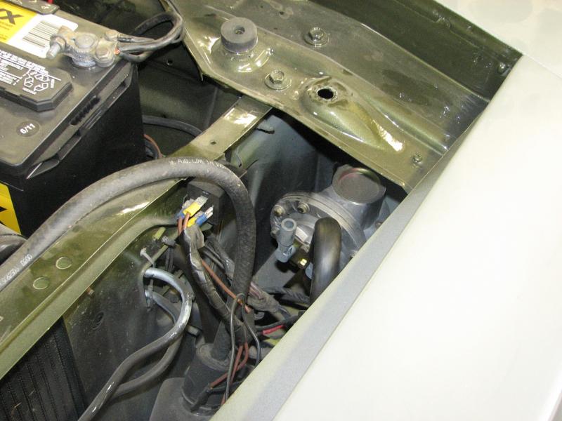

I am using the SSBC kit pictured and also have a reserve vacuum canister. IT works fine now - but I did have a relay fail right away. The relay itself is crappy and the weak point. I just carry an extra one around.

I don't have experience with it - but I would look at that one closely. Looks like it might have a sturdier design.
I have one from MPbrakes it is loud so you want to mount it under the hood or in wheel well out of site. I put my under the dash and not the right place for it. I'm not using mine let me know if you need one we can work out a deal. Might try vac reservoir first to see if that works for you.
The SSBC one is loud too - but you sure can't hear it once I fire the engine up! Either way - I too have been looking at the hydraboost system and kinda wish I maybe went that way - though I just can't get over how weird it looks under the hood. I like things looking stock, but that is my deal...
