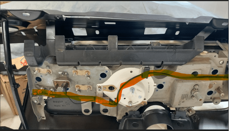

Sounds like more of a grounding issue. Check all grounds including where the dash frame is attached to the car.
I added an additional ground wire on the back of my dash cluster (see highlighted wire).
