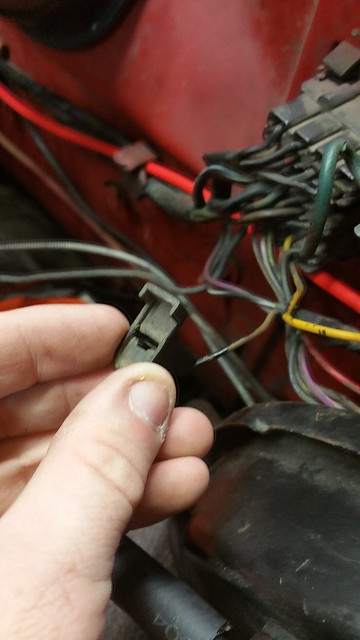

And anyone know what this wire is for?
Check you eng and body grounds and make sure they are clean and tight. Ron
That wire is for the starter relay from the nss switch.
