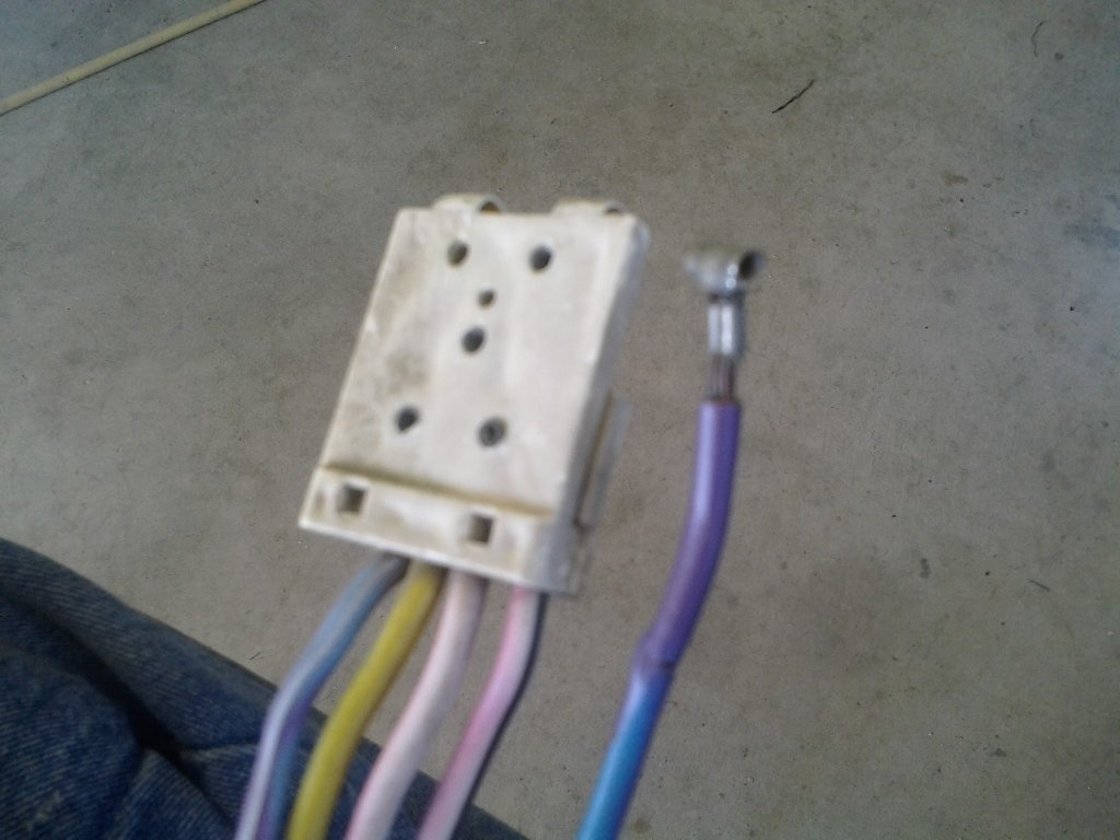

I want to rewire my factory window switch connectors on the 1969 coronet and was wondering if anyone knew where to get these connectors? Thanks
Those are not available from the aftermarket as far as I know. The good news is that all power window cars & trucks up into at least the last 80's use that same connector. I went to a salvage yard and picked up 8 connectors like that for $2. P,.s. that connector looks just fine
The connector is fine but the wire is very stiff and cracked.I hate splices so I may pull the terminals and solder in new wire.Thanks
Put them on relays like I build and the insulation won't be apt to get hard and crusty as the load is greatly reduced. Saves the switches as well.
