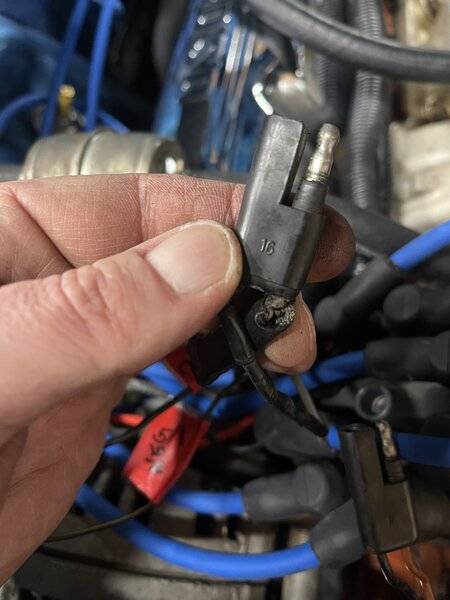

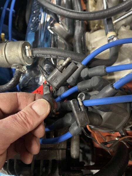

Hi everyone. Could anyone tell me where I might be able to purchase a repair end for an electronic distributor? It’s the engine harness side. It has a “16” on one side and a “EDI” on the other. Thanks very much.

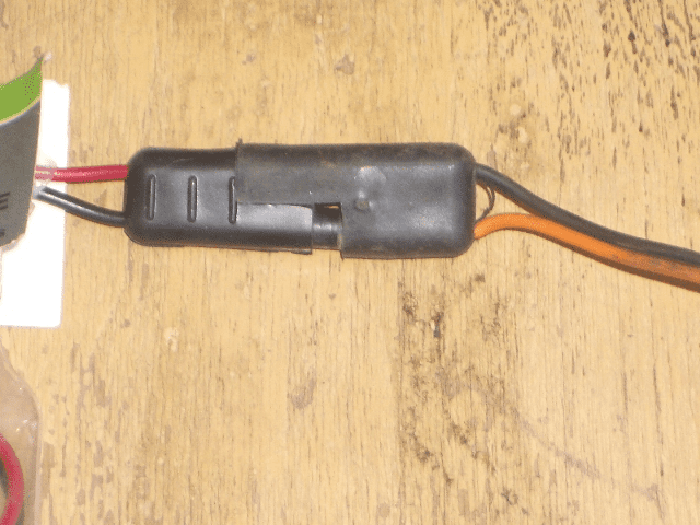

Google it, they're very common and easy to come by ... just search 2 pin distributor connector
Really? I could never find one. Ended up cutting one off an old distributor. Could you post a link please?
These are very common at an auto electric supply store. 2 3 And 4 pin versions.
Yeah, tried those. Won't fit correctly. Not the same as the Chrysler connector. Suggest a trip to the salvage yard. Either end will fit into each other, just make sure the wires are correct. Orange and black are opposite on each side.
I have some I cut from bad pick ups just the ride PM me if you want one.
Why not just replace both ends so they match?
