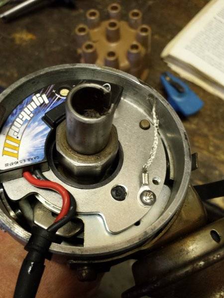

I have had the I and now have the III ..love it ! The III does not have the sleeve that goes over the points cam--uses just the stock points cam. And , it converts back to points very easy if something should go wrong. Take a points set along for peace of mind......................MO
Agree on the III for peace of mind. You just take the points plate out with the 2 screws for the plate and 2 for the vacuum advance. It took all of about 5 minutes. On a SB it was way easier taking the distributor out which took longer than putting the III in. Be very careful with the pot metal. At least on the SM there is only one little tab that keeps the plate from tipping so far the VR pickup is too far away from the old points "star" (which is now the reluctor for the pickup). Break that tab and you have problems. I had to put the plate on a piece of glass with 80 grit and give it a bit of a sanding to flatten the bottom of the casting. It has some roughness that kept it from sitting flat and I broke the tab trying to force it before I understood what was going on. Pertronix sent me 2 new plates with no questions asked. Good company to deal with.

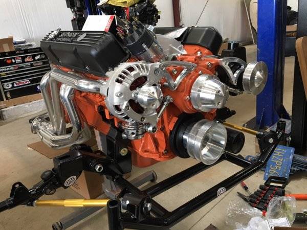

I have been using the RTR MSD and Petronix distributors because 80% of the distributors I pull out to install the iginitors in have too much slop in them. I install the female socket dist cap tho since the RTR comes with male (tho now optional on the pertonix RTR I see). Easy to wire one to ground and the other two go to the coil. I also typically use one light spring and one dark spring that generally allows full advance by 3200 in the big blocks. Have about 6 of them this way now.
I have thought about scuffing it up and painting it cast aluminum as it is shiny. Pic for reference prior to installing female cap.
