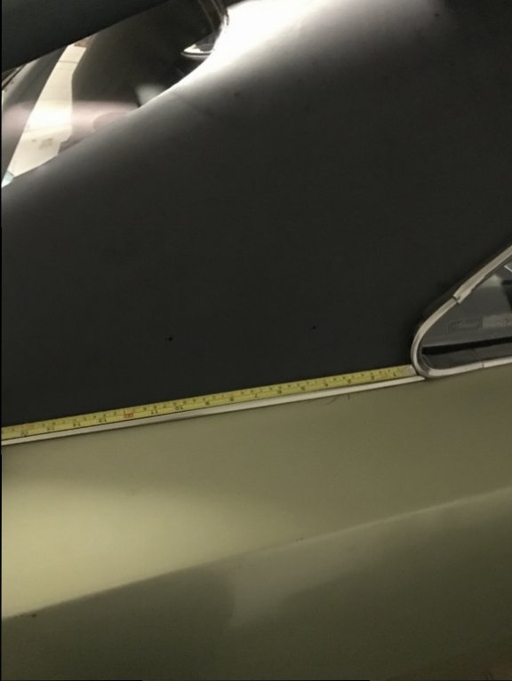

i am reassembling a car i did not take apart, the 1/4s have been replaced, and not drilled, i need to know where the charger script emblems over the 1/4 panel goes. (outer sail panel?) a very close approximate.

You're talking about these two holes right? I can get you some measurements if you need.
Ok, the holes are 2.5" above the chrome trim. I put the tape measure right up against the window corner trim. From that point the first hole is 4" and the second is 10".
